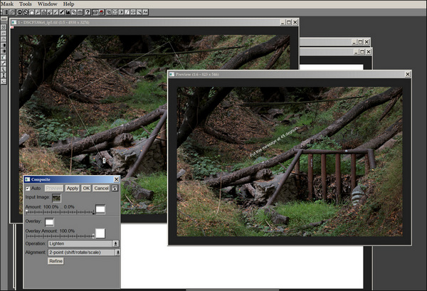

I read Dieter's recipe but did not really understand it; however, but it stimulated me to this recipe, which is probably the same procedure:
(This puts white text on a dark image. The final step explains how to modify the text color.)
1. Create a new white window the same size as the image.
2. Put your (horizontal) text in black on it with the Text transform.
3. Composite: the empty new window is the base, the window with text is the overlay. Composite with rotate/shift/scale.
4. Convert the rotated text window to 8-bit BW so that it can be a mask.
5. Composite: the image is the base, the rotated text window is the mask but use it inverted by setting the white slider to 0%, the black one to 100%. The overlay is the empty white window (or an empty window of desired text color). The operation is Lighten, Darken or whatever works.
Screen capture of final step:
Screen capture
Screen capture
