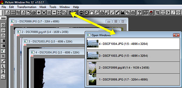

For several open windows [images and/or transforms] in PWP's workspace, you could select: "List Open Windows" from the main tool bar or do a "Control-w"... ...when the "Open Windows" dialog appears use the 'Up' or 'Down' keyboard arrows to reverse sequences... ...you could also use a left mouse click to bring any window to the top being able to switch between two images that are not adjacent in the stack...
...additional features from the F1 Help
The Window List shows all windows in the main work area of Picture Window. A thumbnail is displayed for image windows.
To bring a window to the top, click on it in the Window List.
Close
To close a window, right-click on the item in the Window List and select Close.
Properties
To display the file properties of an image, right-click on the image item in the Window List and select Properties.
[post based on PWPv7.0.17 and Vista 32 Home Premium OS]

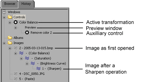

There is also another way to navigate open windows -- the History tab on the browser.
The history tab shows all open windows by category. Control windows are listed first. Image windows are shown in outline-fashion and the operations which created them are identified. You can click on any window listing to bring it to the top. Right-clicking produces a menu with additional functions -- including the ability to redo transformations.
