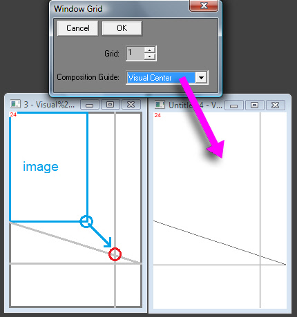

Would it make sense, and is it feasible, to add the attached "Visual center" as another option to the Vertical dropdown list of the Print dialog?
There are certainly various visual centers for diferent purposes, but this one is considered to be the standard or one of the standards in some galleries and exhibitions.
Since the position of the lower right corner of the image is dependent on the image dimensions, placing the image to this visual center on the print would be much easier, if it could be automaticaly calculated instead of having to draw it first on a separate sheet of paper, measure the distance from the bottom and enter it into the Bottom Margin.
The fact is that the image printed in this visual center looks better even if it is not intended for a gallery.

One could possibly modify the "PWCompositionGuidelines.txt" file located in the "<username>/AppData/Roaming/Digital Light and Color/Picture Window" folder with the added text section...
begin_object
name "Visual Center"
line 0.0 0.5556 1.0 0.7778
horizontal 0.7778
vertical 0.8
end_object
Then use the resulting grid lines in Preview of a Composite-Blend 1-point alignment shift transformation where the Input is the background image and the Overlay the 'image' to be positioned.
The above suggested text section is based upon the very small scale of the OP image and would generate grid lines as illustrated below when Window/Grid 'Visual Center' is selected... If there is a specific mathmatical reference, the suggested text section could be refined accordingly.

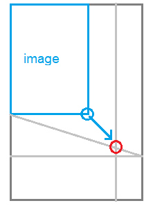

As far as I understood David's concept (wich took me a while to come to a understanding) i would think its a good idea to put it into "Guide Lines" (of which I thought first too).
My understanding of it:
You have a sheet of paper (the darker grey lines) and a image (the blue lines).
First you place the image in the top left corner of the paper and divide the remaining spaces of the paper in half for the light grey vertical and horizontal like.
So if x may be the papers horizontal dimension and y it's vertical dimension, p the images horizontal dimension and q it's vertical dimension, the horizontal coordinate of the vertical lines would be p+((x-p)/2), the vertical coordinate for the horizontal line q+((y-q)/2).
The angled line goes from 0 ; q to x ; q+((y-q)/2) then.
All coordinates with respect to the upper left corner.
After moving the images lower right point to the red circled point this results in a image centered in the horizontal, and lifted slightly in the vertical by that small amount the litte triangle at the red circle.
And that amount depends on either the paper size, image size and image aspect ratio, so it can't be adressed with a single block in Guide Lines.
The Print processor would on the other hand know everything to calculate that coordinates.
The effect is the same as, when matting a print, the bottom margin of the mat is usually cut wider then the top margin.
So, if it's decided to include this, I think ot would be useful to include it in both directions, horizontally and vertically, to be able to lift a landscape oriented picture printed on paper oriented portrait in the printer.
The settings would be "Centered" in one dimension and "Visial Center" in the other, so all possible orientations could be accomplished.
(and sorry for the math-heavy post, but i thinks its the easiest way to describe what's going on)

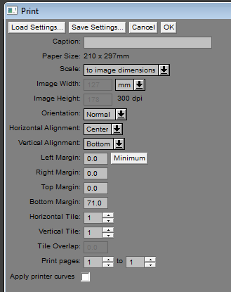

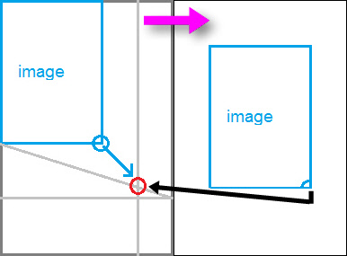

I have just nailed together the excel sheet last evening while waiting for the charcoal for the grill to get ready, so I kept it as simple as possible and did not add the left and right margins as it is easily centered either in Print dialog or Layout.
The way I use it in Print dialog (assuming Portrait oriented picture on portrait oriented paper):
