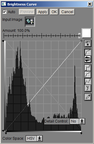

Hello Jonathan and Kiril,
thank you for the update with the new functions.
The version installed without problems and I did some quick tests.
The new "New Brightness Curve Detail Function" seemes promising.
I just want point to a small glitch. If the window of the tool is made higher the switch for the detail function does not reflect this.
No problem if the window is made more wide.
No real problem for me.
[attachment=0]Brightness_Curve.jpg[/attachment

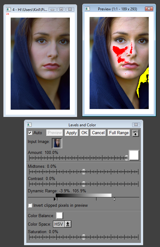

How is "Show Clipped Pixels" supposed to work ?
I cant get any showing of clipped pixels at all, even with very harsh clipping.
I noticed that in Prferences the values for the cliping points can be set from -1 to 256 instead of 0 to 255. Is that intended, and if, whats the purpose of setting below 0 and above 255?

In the example below the Preview shows both shadow (yellow) and highlight (red) clipping. In this case, the clipping was obtained by adjusting the contrast sliders off-scale.
Re: New Picture Window Release
Assuming clipping display is enabled, any pixels in an image or preview where any channel is equal to or less than the lower limit is displayed in the shadow clipping color. Any pixel where any channel is equal to or above the upper limit is displayed in the highlight clipping color.
Setting the shadow clipping value to -1 disables the shadow clipping display; setting the highlight clipping value to 256 disables the highlight clipping display. This lets you enable one while suppressing the other.

I have fixed the problem with the Detail control not being positioned correctly when the window is resized for the next maintenance release.
- Posts: 453
Thanks Jonathan and Kiril, I was supposing it should work that way, but it didn't for me this morning.
Now I found what was the problem.
It does not work when Color Management is disabled or "None" is set for monitor profile.
I'm just setting up a new machine and did not have profiled my monitor, so I hat set profile to none, thats why it did not work.
And thankks for the explanation for the -1 and 256, makes a lot of sense when thinking about it (was a bit in a hurry this morning...).
