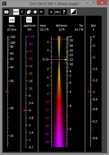

I have been working on a greatly improved version of the depth of field calculator with versions for both Windows and Android (see screen shot below). It comes with a quick start and full reference manual including an extensive diatribe on depth of field. If anyone would like to try a beta of the Windows version, please send me an email (jsachs@dl-c.com) and I will send you a link to the installer. The Android version is also available as a sideload - for more information on sideloading, Google "Android sideload".

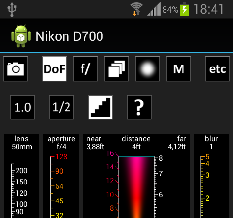

I have installed DoF for Android on my Samsung S2.
According to the Screenshot the button for changing units should be right of the "etc" Button, but the S2 runs out of screen realestate ..
The "etc" button is the most right one visible, so no chance for me now to change units.
Edit: Screenshot added

Dieter,
I was able to reproduce this problem using the Android emulator - I have uploaded a new version to the Google Play store which has smaller icons for phones with lower resolution which should work better. It should be available within a few hours and show up as version 4.0.5.
