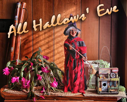

Re: Writing on the picture
Jerry,
Beside Warp for perspective changes you can also use Fan to give the text a curve, using the same mask method Jonathan described above.
See here for more details:
http://www.dl-c.com/discus/messages/2/5281.html

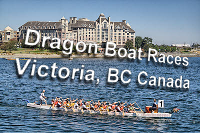

I usually will do...
1) create an 8-bit BW Text image, ie, an image with any text with the approximate/same pixel dimensions as the base image: white letters and a black background... ...this Text image can be its own mask because it is 8-bit BW...
2) Composite Blend where Input = the base image with Amount 100%; Overlay = the Text image and the Overlay Amount Mask = the Text image where white = 100% and black = 0%; Alignment = 2-point [shift/rotate/scale] or 4-point [perspective warp]... ...position Alignment points/guides to preference... ...click Apply
3) Reset the Overlay Amount Mask so that both white and black = 100%... ...click OK. You will now have a new Text image image that when Convert-ed to 8-bit BW can be used as a Drop Shadow mask in step 4) providing the Alignment points/guides were outside the pixel dimensions of the Input base image... ...if the new Text image background is not completely black: use a black Paint brush to make it so... ...this is needed when adjusted Alignment points/guides in step 2) are inside the base image pixel dimensions.
4) add a Drop Shadow to the resulting step 2) image using the 8-bit BW step 3) image as the mask in the Special Effects/Drop Shadow transform... 5) you could also use the resulting 8-bit BW step 3) image as a mask to change the text color to a preference using Composite-Blend where the Overlay is the color of preference...
Just one possibility of many limited only by imagination ... ...I used PWP5 to generate the illustration but the suggested workflow is the same for PWP6 and PWP7...
Have fun...
Have fun...

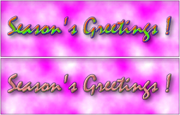

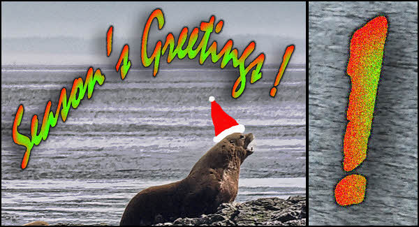

Will try to post something by Friday, 11/21... ...I seem to be having some internet connectivity issues.
Thought that this might be a good workflow to explore as it involves: Fan; Perspective; Dual colors; Outline; bright RGB noise (glitter); and floating above the base image......den...

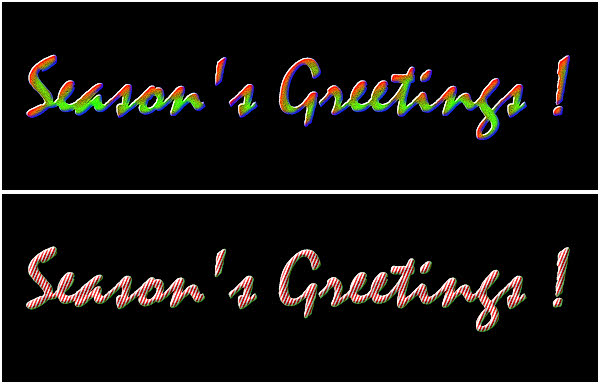

Reference: http://www.ncplus.net/~birchbay/tutoria ... 141123.pdf
The following are two 24-bit color Text images [black background with colored text] that were developed using a bold Mistral font and successive Drop Shadow transformations with an Invert-ed [white background, sharp edged black text] Mask-Drop Shadow mask and four drop shadow colors: green; red; white; and blue at 100% Saturations and Values... ...followed with added RGB Gaussian noise at Amount 70%... …the Drop Shadow settings were chosen so as to provide a 3D or raised text appearance… Free, no restrictions, full sized Text image versions may be downloaded here [2310x740 pixels, 333KB]:
http://www.ncplus.net/~birchbay/tutoria ... _image.jpg
For a curved Text image, use the Fan transform with a preference Curvature and Background color = black.
The Reference pdf explains creating/using required masks for text outlines and drop shadows when Composit-Blending the suggested Text images to a Base image... Ask if there are questions... ...This is briefer than I intended but Life is intruding on hobby time...
