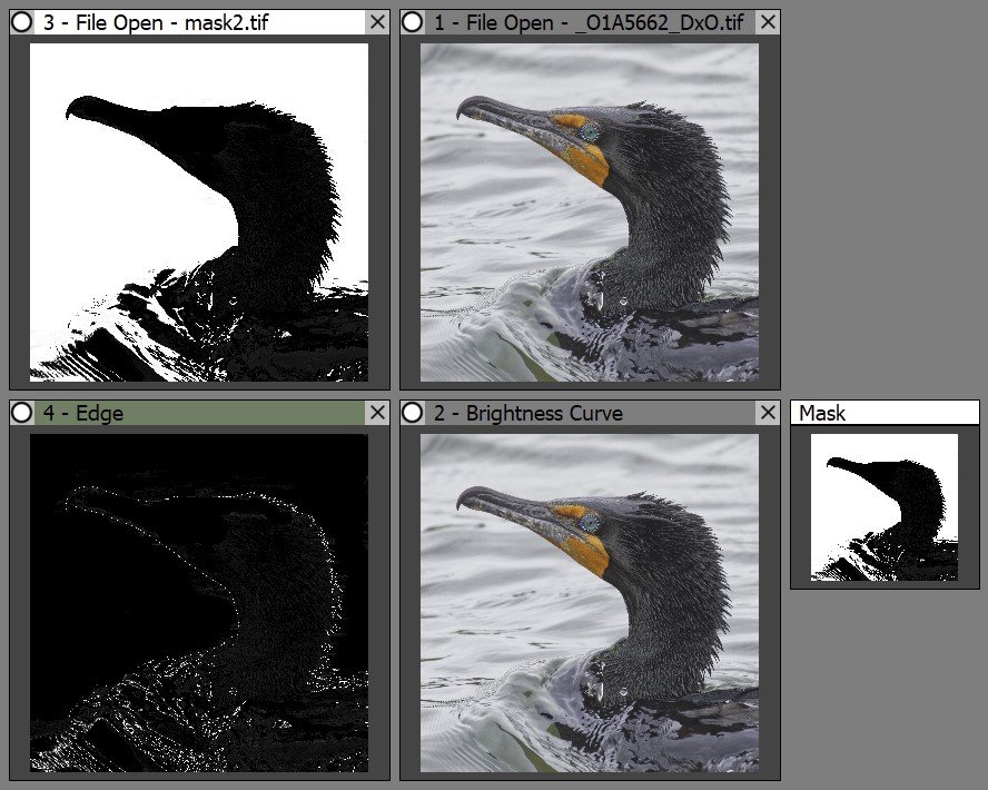

Looking at the mask command, it appears you applied the Mask Paint tool roughly 530 separate times when you built the mask, painting one tiny part of the outline at a time.
The way Mask is implemented, this uses a huge amount of memory since it make a copy of the previous mask image before starting each new operation. If the input image is large, this might be causing out of memory problems which I admittedly do not handle gracefully in all cases. I think this also accounts for the very long time to rebuild the mask.
I am not sure why you would want to paint the edge by hand in any case given that the subject is dark and the background is light, there are easier and more accurate ways to generate an edge mask, such as increasing the contrast of the image and using the Edge transformation.
To produce the above, I used the Mask Separate tool, the increase the mask contrast with the Mask Brightness Curve tool and cleaned it up a little with the Mask Paint tool. Then I saved the mask as an image and applied the Edge transformation to it.

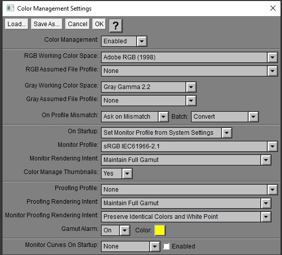

2) Can you post a copy of your color management settings file (or a screen shot of your Color Management dialog box). The settings file is located at:
C:\Users\<user name>\AppData\Local\Picture Window Pro\Color Management\Settings.color management

See attached.
- ColorMgtScreenShot.jpg (62.81 KiB) Viewed 4161 times
