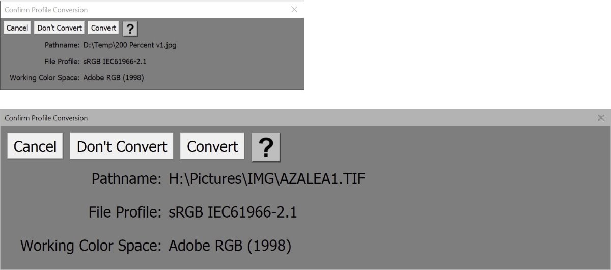

Can you post a screen shot of one of the PWP dialog boxes? Attached is what the same dialog box looks like at 100% and 200% here.
Many improvements were made in Windows 10 to support high dpi monitors and scaling of the screen, so if you are using an older version of Windows, this feature may not look the same on your computer.

The size of my dialog box changes appropriately, just like yours.
I have Windows 10 version 1903 build 18362.720
Display resolution is 2560 x 1440
I have taken screen shots at 100 and 200% of a dialog box plus that dialog's help. As they are too large for inclusion here, I will send them as attachments to an email.

It looks like it is working the way it is supposed to. You can't change the size of help text or menu text except by using the Window Display control panel and changing the scaling percentage.
