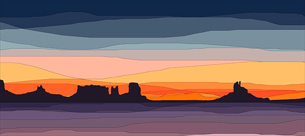

Thought I would add a comment or two, in addition to what Jonathan and others have already posted, just to give you an idea of what I was trying to accomplish. A while back (as in years) I did up a series of images that combined a mask (or two) in combination with hand drawn lines across the page to get some graphic results (although they were based on images I had taken in the American southwest, the results were markedly different from a photographic image). At that time, I did not obtain smooth lines by free-handing the lines, so thought I would give it another try. As a result of my questions and Jonathan's responses, I tried the Line and Arrow tool. The lines were drawn across the entire image, so did not need to be a completed circle, and as I indicated, I wanted them smooth.
Attached are two images, one of the originals from a while back and the second, one that I am using to generate masks, by flood filling each section with a mask, then using that mask in another image. I also used the line image as a mask for the section outlines.
Hope this clarifies.
