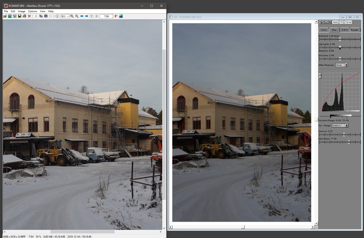

Back then I had a small Canon G5. I shot RAW, converted with BreezeBrowser and edited the images in PWP and tried to learn the in and outs from people here at the board. I was off photography for quite a few years. Now I have an Olympus E-M1 and try to do the RAW processing with PWP. I'm not doing very well. I gave it up for a while and thought I'd shoot JPG until I had learnt the camera better.
My main problem is that with the standard settings my photos becomes so dark. I need to up exposure about one stop to make them have the same brightness as the out of camera JPG. I tried Olympus own software and the RAW images didn't come out darker than the JPG. Obviously I'm doing something wrong. But what?
I attach a couple of screen caps of my settings and the RAW preview in PWP and the JPG in IrfanView side by side. I've used RAW+JPG when shooting and the JPG is straight out of the camera, not edited in any way.

Without seeing the original files, my guess is that on the Gray tab you need to drag the white dynamic range slider to the right until is is more or less under the white end of the gray ramp.

Thank you. I don't know why I've overlooked that. I guess that corresponds to Levels and Colors | Dynamic range? Odd though that all pictures turn out that way, with seemingly compressed dynamic range. Is that normal?

I spoke too soon. The image looked so much better with expanded dynamic range. But when I compared to the JPG it was still dark, even if not as much. And I think I actually used the dynamic range slider when I first tried this and gave up for while.

As expected and explained by Jonathan, expanding to full dynamic range changes a lot. The next thing you could do is to use the midtone slider under the "grey" menu.

HanSch wrote: December 16th, 2019, 6:53 pm As expected and explained by Jonathan, expanding to full dynamic range changes a lot. The next thing you could do is to use the midtone slider under the "grey" menu.
Yes, I can fix the darkness. Exposure compensation works best. I'm just wondering why I have to. I've tried about 10 other programs (went on a spree yesterday) and they all turn out an image with the right lightness without having to adjust things like that.
My basic settings are OK, aren't they? Gamma and such? Anyone else here use Oly?
