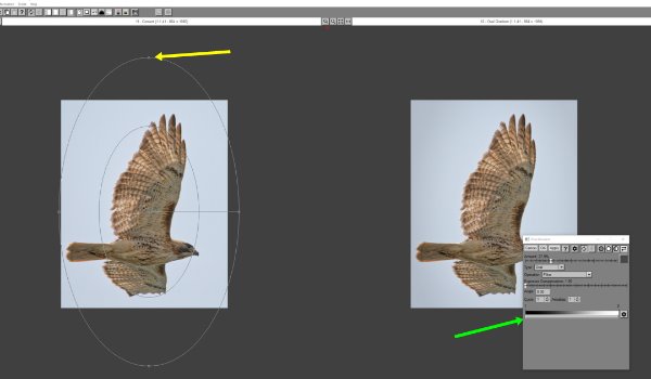

So, as a workaround I converted the 48 bit image to 24 bit in order to add a bit of a vignette with the oval gradient transformation. In doing so, I found a couple more problems. The top control handle on the oval gradient doesn't seem to work. See yellow arrow in screenshot:
Also, when I went back to "edit" this transformation (to make the screenshot) I found that the gradient curve UI is not displaying properly. See green arrow in screenshot.
