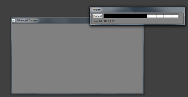

I am sorry for the vagueness. The precise description should have been "Dragging transformations dialogs with their own preview window ..."
Only these transformations have Compute entire output image button mentioned further.
The attached image is the Advanced Sharpen dialog set to maximal values make it possible to catch its progress bar after the dialog was dragged along with mouse and then released. About 1 sec time to achieve it.
I believe that with fast PCs the progress bar is not visible at all after the dialog has been dragged and released.

Re: Something about Advanced Sharpen
This is a side-effect of a different and much more important optimization I made earlier, namely to prevent the constant recompute and redraw of the dialog window when resizing. Unfortunately, the Windows message sent when resizing is complete is also sent when the window is moved, so when you release the mouse button after dragging the title bar, there is one recalc of the preview. I don't see any easy way to prevent this off-hand, but I will look into it.
Update: I found a simple solution and have fixed this.
