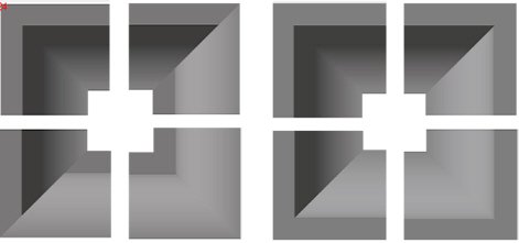

All beveled frame profiles seem to have incorrect right and bottom sides. The left example in the attachment is Round Beveled profile in PWP 8.
Right 4 corners is the same profile in PWP 7.
Beveled frames.jpg (9.72 KiB) Viewed 1670 times

Fixed for next release. It looks like I added some code at some point to fix some other problem but the fix had unintended consequences. Removing the extra code makes it work the same as PWP 7.
