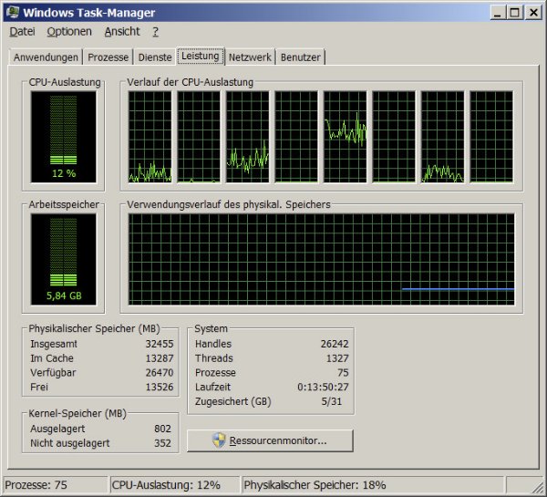

Maybe this helps:
It takes one thread of my 4 core/8 thread cpu.

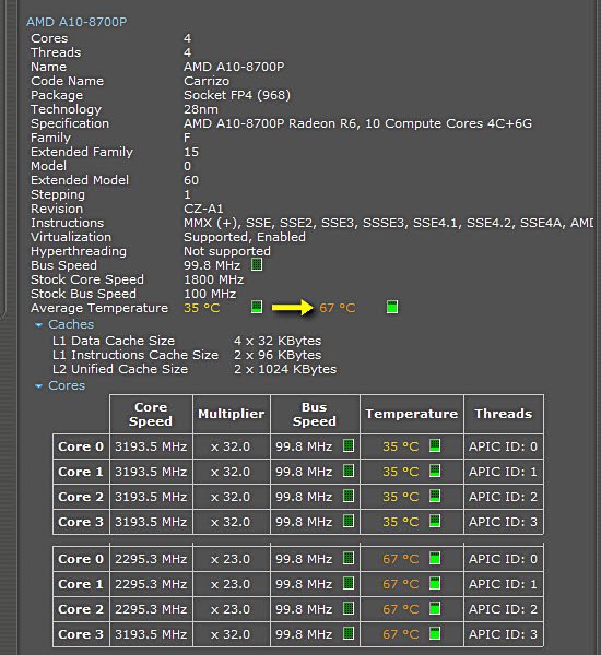

1) Core temperatures rose from 35C before to 67C after 1 minute of a Ctrl-F Display
Core Temp before-during.jpg (86.23 KiB) Viewed 8940 times

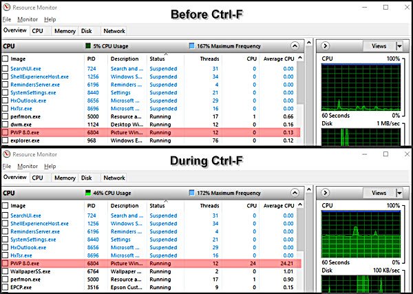

2) PWP 8.0.exe CPU usage rose from <1% before to 24% during a Ctrl-F Display
PWP8 CPU usage before-during.jpg (82.29 KiB) Viewed 8940 times

If there is, I can't see it immediately after turning off the Ctrl-F Display to see the Resource Monitor dialog... ...the tasks are displayed in descending order of CPU usage and there is nothing approaching the 24% ave usage of PWP8... ...and I cannot resolve the difference between the total CPU usage 46% and the 24% PWP8 usage.

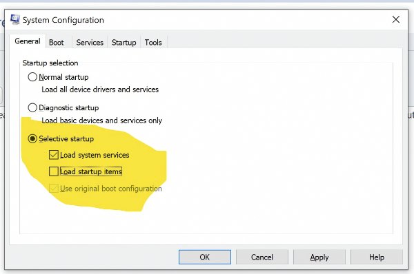

I'm sure you've already done this, but one thing to do to diagnose such performance issue is to start Windows without all the start-up items in the background, i.e. run msconfig.exe and select the following options before restarting the computer:
Annotation 2018-12-24 124438.jpg (30.41 KiB) Viewed 8866 times
This at least establishes a base-line for comparisons.
