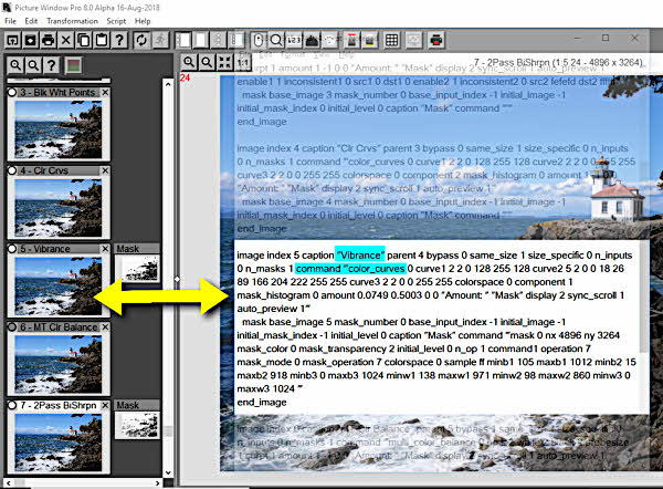

Perhaps a "reader tool" for a saved 'embedded script' option-ed tiff file open in the Browser... ...even if the Browser thumbnail names and/or image numbers change, the embedded script provides the transform used:
Screenshot (4).jpg (282.52 KiB) Viewed 2843 times
Might also be an on the fly 'power user' script editor tool; program crashes notwithstanding. ;-)
