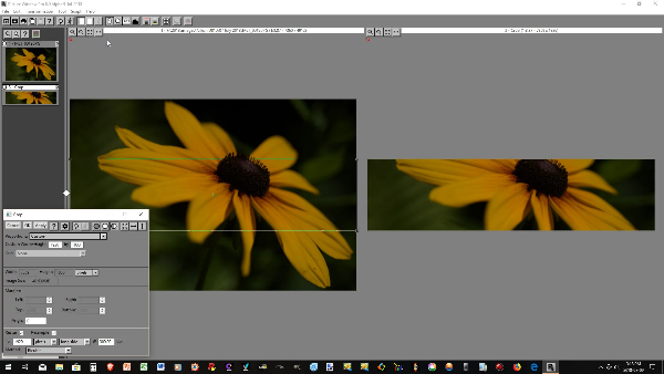

Crop still starts with incorrect selection (for horizontally-oriented images):

The text in the image you posted is too small to read, so I'm not sure what exactly what settings you are using. A couple of points:
1) You may need to rebuild your default and other settings files (if any) to get crop to work correctly.
2) I assume you realize this, but while the Custom proportions are displayed as width/height, but are really proportions as in "8 : 10" and not the actual size of the cropping rectangle in pixels. I have changed the dialog text to reflect this for the next release as it could be confusing.
If neither of these helps, I may need more information to understand the problem. When I try it here, I get almost exactly the same proportions whether the input image in horizontal or vertical (since dimensions are integers you can't generally get an exact match).
Re: Bug fix release 9-Jul-2018
Thank you Jonathan, clearing and resetting the default settings, and starting over to set a "new" default setting seemed to do the trick.
