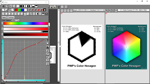

3) Selecting 'Edit Transform...', then 'Edit...' Amount Mask will clear the lines in the mask...
Saved Script screen view 2.jpg (131.28 KiB) Viewed 2963 times
4) A transform OK results in an expected processed image...
Saved Script screen view 3.jpg (146.47 KiB) Viewed 2963 times

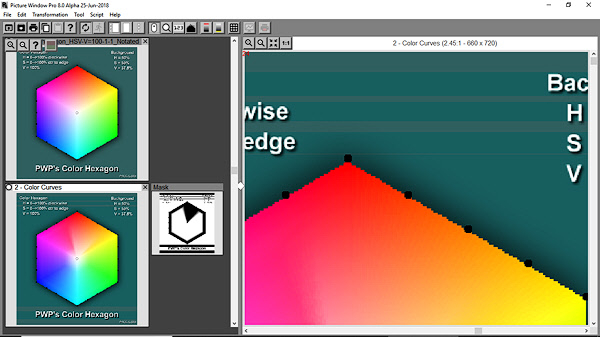

Ref: PWP 8.0.exe 180626 -- mask lines still present with crash for large images
Program consistently disappears from desktop with no warnings or errors when script is open with a 4896x3264 pixel, sRGB, jpeg image of 8.64 MB. Mask lines, if present should be readily apparant if the Open Image File dialog selected image for the script contains large areas of blue sky...
The illustrated image [PWP Color Hexagon] in the following screenshot is 660x720 pixels, sRGB, 24 bit tif, 1.6 MB...
Screenshot 180626.jpg (153.76 KiB) Viewed 2947 times
