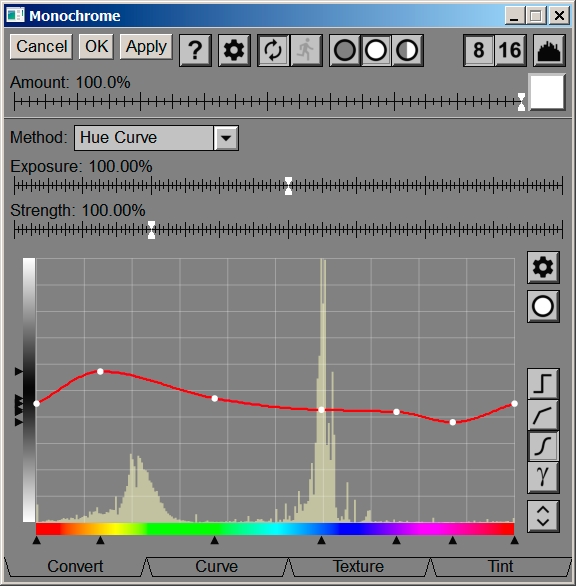

Let me say, that I really like the new Monochrom Transformation and I like how the H-Curve is implemented.
To my observations the H-curve changes the Lightness/Value of the selected color. So it is possible to darken the sky or lighten the green or red or ..
This is a great function. I am thinking about doing a coarse mapping of the viewable color of the spectral to the HSV-colors, take the spectral response curves of some old B/W-films and adjust the H-curve accordingly. The result should be a more closer look of the old B/W-films.

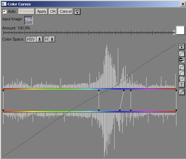

On the other hand the H-curve in the Color Curve Transformation changes the hue. Frankly I like the implentation in PWP7 more.
Shifting tone of a sky from magenta blue to a normal blue works more easy for me with PWP7.
