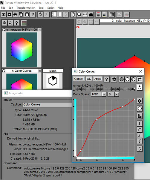

Screenshot PWP 8.0.exe 180401:

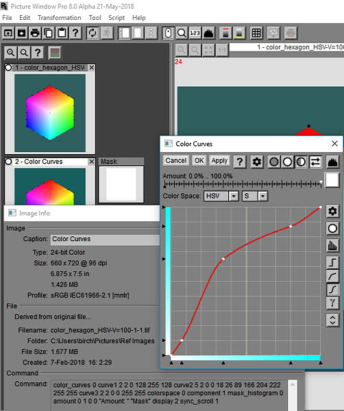

Screenshot PWP 8.0.exe 180521:
Screenshot (3).jpg (199.58 KiB) Viewed 3104 times

Jonathan... ...for the mask in the script something is going on with the Undo-Redo for PWP 8.0.exe 180521 because if you run the script and then do an edit of the mask and select Undo you get the desired mask although it is inverted.
Let me know if you need screenshots...

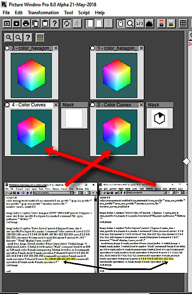

I was able generate a proper script mask with PWP 8.0.exe 180521 by updating the script as illustrated in the following illustrations: the left browser tree is the script posted above and the right browser tree is using an updated script. The highlighted script text is the difference between the old (on the right) and the new properly working script text (on the left)...
Screenshot (6).jpg (240.18 KiB) Viewed 3088 times
Screenshot (5)-1.jpg (88.15 KiB) Viewed 3088 times
The revised working 180521 script:
