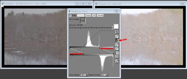

If I understand correctly what you are trying to do, here is how I would do it using Gray/Brightness Curve:
1) Click the Show Histograms button (the 2nd one below the Opt button to the right of the curve). This will display the histogram of the input image above and the output histogram below.
2) Drag the upper right marker to the left until is just touches the right end of the upper histogram.
3) Drag the lower left mark right by the same distance you moved the previous marker to the left.
4) Click OK
4) Click OK
- Shift.jpg (61.46 KiB) Viewed 3974 times

Thanks Jonathan, I will try your suggested method.
