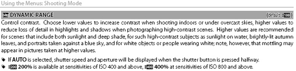

Re: Expanded Dynamic Range
At least for the Fuji X cameras, I believe the curve adjustment is done on the camera JPG. not the raw. Obviously, the ISO modification affects the raw.
Per the attached excerpt from the XE-1 manual, you can use the Dynamic Range option with a variety of exposure settings.
The XE-1 has excellent sensor range. In the most demanding instance, you set exposure, shutter, and ISO as a sort of linear programming problem: the aperture for aesthetic effect, shutter that you need to avoid motion blur, and ISO raised against shadow clipping. You will get a good photo out of the raw plus PWP.
- FujiXE1_excerpt.jpg (81.88 KiB) Viewed 5397 times
Charles,
1) what's 'mottling'? Low frequency noise at high ISO required for DR 400%?
2) what exactly does AUTO DR in X-E1 do?
Cheers!
Cheers!
