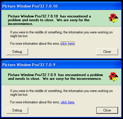

No, I do get the usual error happened window, so it's reasonably well behaved, not a hard crash pure and simple.
My XP SP3 is EN-US and is fully up-to-date, including this month's updates as released by MS on patch tuesday.
I've done some more tests and attached the resulting logs, as a .7z file

Both crash exactly in the same way.
Another possibility for the origin of the problem is if PW70.EXE relies on SSE2 instructions, while PW60.EXE does not.
The Athlon XP (Barton) is not SSE2 capable, although it processes SSE and MMX.

I guess I've just hit jackpot! And, in fact, I don't like it a bit... :(
PWP7 (v 7.0.10) runs OK in demo mode on my Asus Eee PC 900, which has an Intel Celeron M 353 (900 MHz) and 2 GiB of RAM...
This seems to confirm the issue is really related to lack of SSE2 support.
Is there any chance of a non-SSE2 build being in the works (even if just to settle the point once and for all)?
Thanks a lot for all your help and replies.
