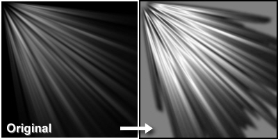

There is a "customized light beams" tutorial to be found on the DPR-Retouching forum here: http://forums.dpreview.com/forums/read. ... e=42327932
I was unable to duplicate the tutorial easily as there is no Zoom to the Gradient transform's Radial Sweep, so I took the author's final Example image, modified it to have full dynamic range about a 50% gray tone background for use as the Overlay in the Composite-Soft Light or Hard Light transform with Alignment: "2-point (shift/rotate/scale)".

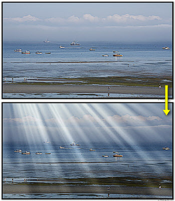

An aggressive example [Soft Light Overlay Amount = 100] for illustration purposes:
A higher resolution and less aggressive application example is the top image where light beams have been subtlely added to the clouds and fog, posted here: http://www.ncplus.net/~birchbay/12/IMAG ... _12_92.htm.
While the modified template image will be of general use as it can be mirrored; and/or a 50% toned color cast temperature of 4500K added to provide late afternoon sunlight ambience; and/or 'shifted/rotated/scaled'... ...it might be useful to be able to create alternate beam arrangements.
Does any one know a way in PWP to duplicate the Zoom? ...or have a PWP 'beam' workflow already in hand they could share?
If there is further interest, I can upload the suggested PWP modified LightBeam template image [900x900 pixels, 24-bit Black/White, 100% Jpeg quality, 191KB] and post the 'link' for unrestricted use by all...

Re: ...Customized Light Beams?...
Seeking tutorial author's image use permission... ...den...
BobC and Andrew...
The difficulty I had with the available PWP options [drop shadow, gradients both linear, oval, and radial, displacing gradient blurs, etc] was that I could not get away from a contrived, too uniformly repeating pattern for the beam template and the required intensive manual sequences... ...which is why "gl2k"'s resulting tutorial image attracted me... ...the suggested PWP modified version seems to be very generic and usable in a variety of ways resulting in a 'natural' effect when subtlely applied...
...in any case, 'permission use' is given and a download image and illustrations are here:
http://www.ncplus.net/~birchbay/tutoria ... eams01.htm
...enjoy... ...ask if there are questions... ...and feedback would be useful if successes are achieved...
I have added an Alternate Beam Template image where there is no tone reversal along the length of the beam to the web page: http://www.ncplus.net/~birchbay/tutoria ... eams01.htm
The alternate template will produce more natural beam effects near the 'origin' point and along the entire beam length...
The original template will produce more natural 'drama' if the effect is limited to the last two-thirds of the beam length [ie, exclude the origin]...
...have fun...
