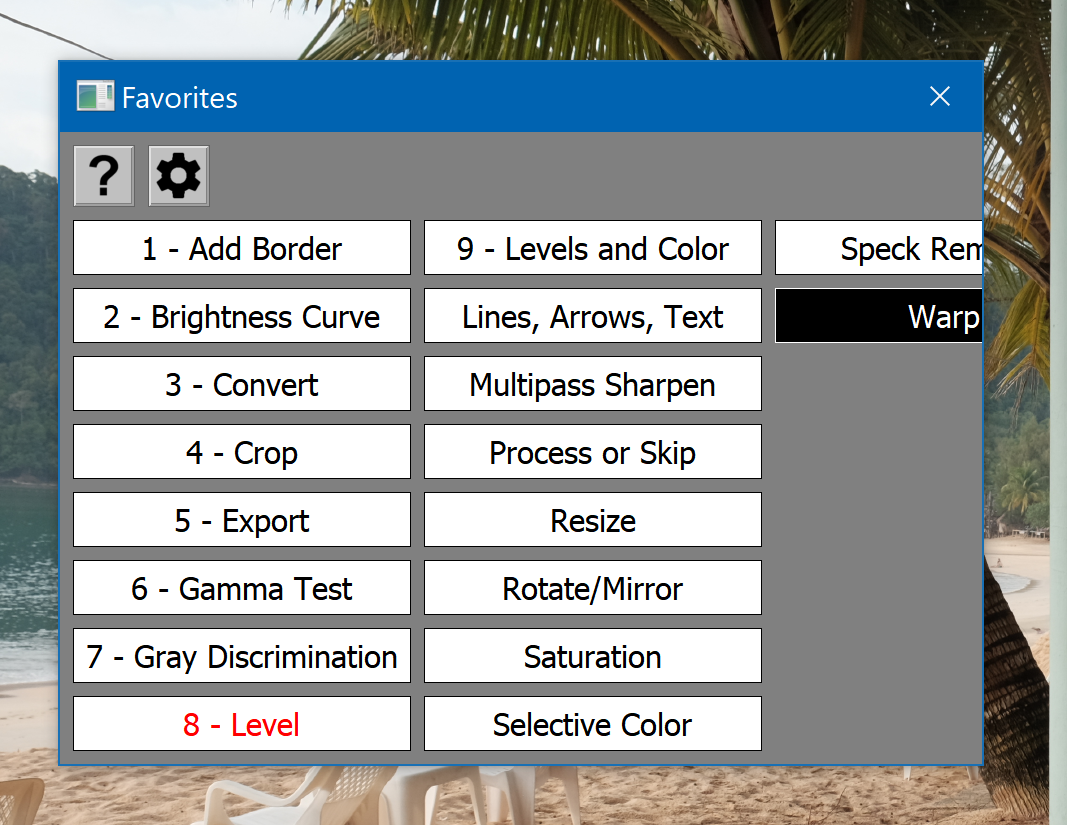

The Help helped me figure out how to rearrange the favourite transformations. Great! A question: once I organise my Favourites, then auto arrange them alphabetically, is there a way of going back to my custom arrangement or do I have to move them around again?
Also, these may be my screen settings, but I the Favourites window is not resizable and on my screen the third column is cut off.

- Screenshot 2025-05-01 165620.png (509.25 KiB) Viewed 22276 times
Re: Manually rearranging Favorites
For the next release, I fixed several issues related to automatic sizing and displaying of the Favorites window.
Once you sort alphabetically, the manual order is lost.
