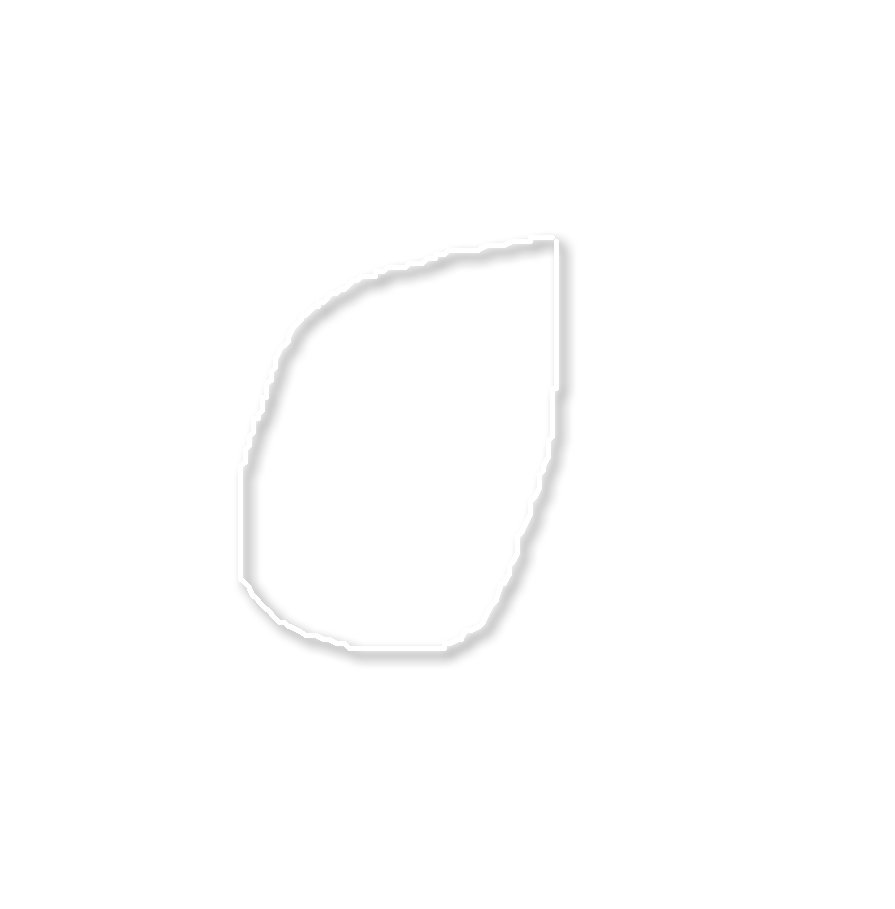

1. I tried using the Edge Transform (which worked to distinguish edges between hues/tones) which I converted to a mask, to place drop shadows on the various shapes. However, as expected, the edges created an encircling mask around the shapes which resulted in the shadows also being introduced within the shapes. Without making multiple (and I mean a lot, pretty well impossible) masks, one of each shape, is there a way to do something similar to an Edge but have the Drop Shadow only on one side as if it was a solid mask? (that's the one I doubt is possible).

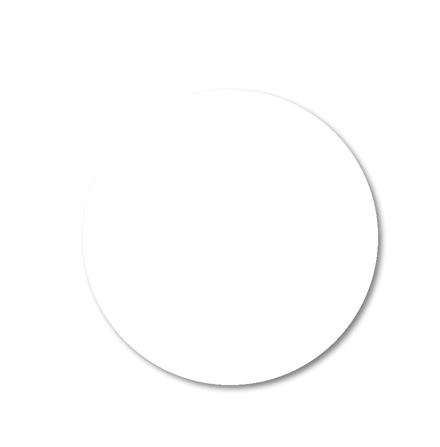

2. In doing this testing, both with an edge mask around a shape (so a crude circle) and a solid mask (in this case I just did up a quick round shape), when the Drop Shadow is used, it produces a slight shadow on the opposite side of where it is intended. How do I prevent this? I will try and attach a couple images to show what I mean.
3. And a follow-up to 2, I also notice with the circle shadow, the shadow extends well past the spot where the shadow should actually start (ie into the area which should have no shadow). Again can I do something to prevent this?

Managed to resize:
- DSEdge.jpg (10.54 KiB) Viewed 5975 times
- DSCircle.jpg (12.71 KiB) Viewed 5975 times

Re: Drop Shadow
You could try to flood-fill the edge mask (there is also a Fill tool which does this on images rather than masks).
This is a result of the blur radius -- the blurred shadow can extend beyond the object. Set the blur radius to 0 if you want a hard-edges drop shadow.

The problem with Flood Fill is the edge mask is not perfectly formed/solid and has "bleed-through" areas which would allow the Fill to spread. But I will play with this idea.

And the same confusion for the last point - I am wishing to do a blurred (in this case Offset 100, radius 10) shadow, not hard edged. But I find that if the light direction is from top left as an example, the shadow extends towards the bottom right (expected). This works fine on a straight line mask (say from bottom left to top right), but if the object is a round circle in the middle of the image, the shadow slowly fades as it wraps around the circle back towards the direction of the light, however it continues past the point that the light should prevent a shadow from existing. In fact if the background is white and the object is white, one can see a diminishing shadow all the way along the lit side of the circle (a close look at the circle image I posted), which it shouldn't have. Of course the darker the background, the less this is visible. I only noticed it as I was working white on white, but it is still visible on backgrounds which are less dark than the shadow.

I believe the drop shadow is being computed correctly -- blurring of the drop shadow is modeling what happens in the real world when the light source is not a point source. This implies that light is coming from more than one direction at a time.

Showing steps doesn't have any relevance and after doing the operation again, I think I may see where my confusion partially comes from. I have been assuming the light source is some distance from the "object", where I think the image may suggest the light source is extremely close to the object (So the farther away from the object the light source is the shadow should start farther along the curved surface towards the shadow side).
Having said that, in the image I posted of the "sphere", there is a visible faint line all the way around the sphere to a point closest to the source (unless my eye are playing tricks on me). There should be no shadow on that lit side adjacent (?) to the light source. If one were to take a cylinder (stood up) and shine a flashlight on it from the side, there will be no shadow visible on the side of the cylinder where it receives the direct light. Of course, the farther along the curved edge, away from the light, a shadow starts to appear.
