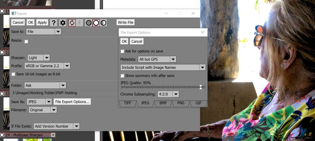

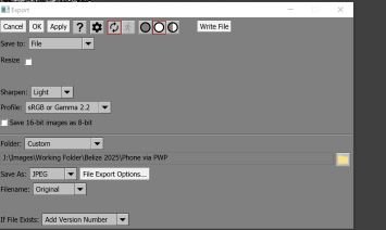

This was just a one off and not part of a batch.
Tue 1.jpg (93.37 KiB) Viewed 8302 times
Tue 2.jpg (18.29 KiB) Viewed 8302 times
It worked on the previous image but not on the last one>

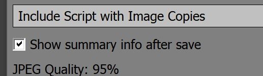

Tue 3.jpg (14.6 KiB) Viewed 8267 times
Using this tick box might be making it more reliable - but it does not 'show' me anything in PWP.
Should it?
EDIT. Just reminded that there is a setting in the transformation to choose between batch and script. Maybe that is what I was failing to adjust.
I'll try again tomorrow - with a fresh brain.
Posts: 4886
Re: Script saving and Export options
Show summary info after save is disabled during batch operations as it requires user intervention each time.

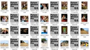

Wed 1.jpg (21.52 KiB) Viewed 8105 times
Working fine with a batch and naturally no repeats.
But as soon as I do two repeats it gets one without a script and one two versions of the script.

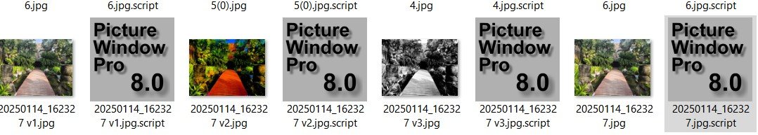

wed 2.jpg (934 Bytes) Viewed 8091 times
Posts: 4886
First, what setting are you using in Export with regard to what to do if the output file already exists?
I noticed that if you select Overwrite or Ask and then select Overwrite, the old script files were not being deleted along with the image file. I'm not sure if this is what is causing the problem you are seeing.
In your message, what do you mean by repeats? Running the same batch multiple times? Having the same file more than once in the file list? Something else? In the images you posted the text is too small to read so I can't see what is happening.
