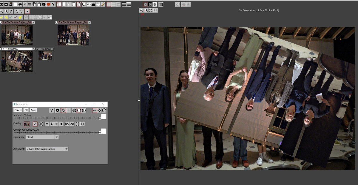

I had to shoot a 'curtain call' that was wider than my camera lens so I took several shots panning across the actors.
In the past I have used Microsoft's Image Composite Editor but decided to see if I could replicate the action in PWP8.
First question. Can I work with two images that support two trees of transformations? I'll never get the tones to match properly until I see them in the aligned composite image. If I can't I think I'll stay with the Microsoft system.
Second question based on the fact that 'automatic' comes up with this mess.
Wed 1.jpg (116.02 KiB) Viewed 9529 times
Clearly I need to do some 'refining'
Should I have the alignment multi-point or do I use the two point?
I felt the best place to make the join was the pillar to the left of the lady in green. Using multi-point I put the right hand point 2 on that pillar using the overlay image which is the left hand shot. As soon as I do that I distort the image making all the actors short and fat. I then went to the input image and tried to put points 1 and 3 on the pillar but that seemed to retain the overlay image.
I am working with the smaller Overlay thumbnail as per the Help screen.
Question Three. If I get these points set correctly do I then to refine the two images with masks to hide the bits I am not using.
Sorry! I have a lot to learn and maybe I am asking the impossible!
