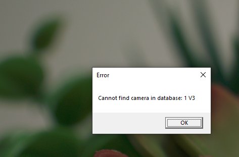

Hello,

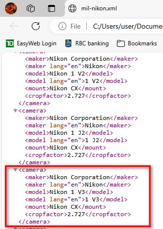

Interested to see the adoption of the Lens Fun database, but I'm confused as to how it works. I tested by opening a NEF (Nikon raw) file from the Nikon 1 V3 camera, with the CX 18.5mm lens, but when I open the RAW transformation, I get errors about the camera not being in the database, and the Lens and Camera profile options show 'none". When I check in the database, it appears that both the camera and lens are listed.
Is there something else I need to do or a step I've missed?
Thanks for any suggestions.
Mark

I did fix a problem with the latest release that might have been causing the error, but there are a lot of complications in using LensFun. If you are already using the latest version, please send me one of the raw files (jsachs@dl-c.com) so I can figure out why it is not being recognized.
