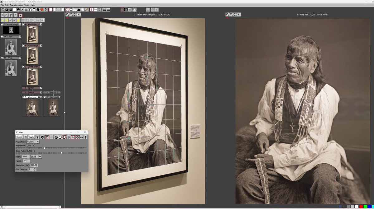

Auto computation of proportions is off.
Example :
I took a picture of a photo in a museum.
The actual proportions of the photo are 1,382 : 1.
I computed the proportions from another picture provided by the museum.
When corrected automatically using Warp, PWP computes proportions as 1,561 : 1
2024-11-15 PWP Warp auto v1-resize.jpg (119.92 KiB) Viewed 2908 times
To obtain the desired correction, user has to use custom proportions.
2024-11-15 PWP Warp custom.jpg (120 KiB) Viewed 2908 times
Posts: 4908
Re: problem : warp transform auto proportions
Auto-proportions just makes a guess that assumes the middle of the frame is correctly proportioned. This usually works OK if you photograph something head on, but not from the side.

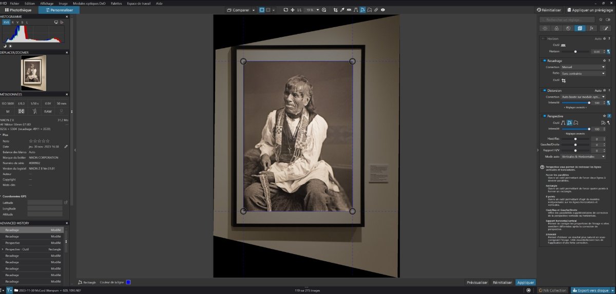

The perspective computation could be improved. I compared with DxO Photolab 8.
Photolab automatically computes 1.5, which is much closer to reality.
2024-11-15 DxO Photolab 8 Warp auto.jpg (75.85 KiB) Viewed 2901 times
Posts: 4908
Yes, you can do a better correction but only if you know the focal length of the lens and the size of the sensor and do a lot of complicated geometry. The approximation in Warp does a good job on images landscapes and other images if you point the camera up or down a little which is the most common case. Otherwise you can set the proportions manually.
