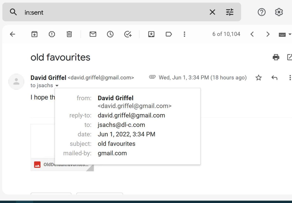

I haven't seen any message yet -- probably easier just to cut and paste the text into a post.
Re: PWP won't start
Odd that you didn't get the email. It's in my Sent folder, and I haven't had a bounce-back.

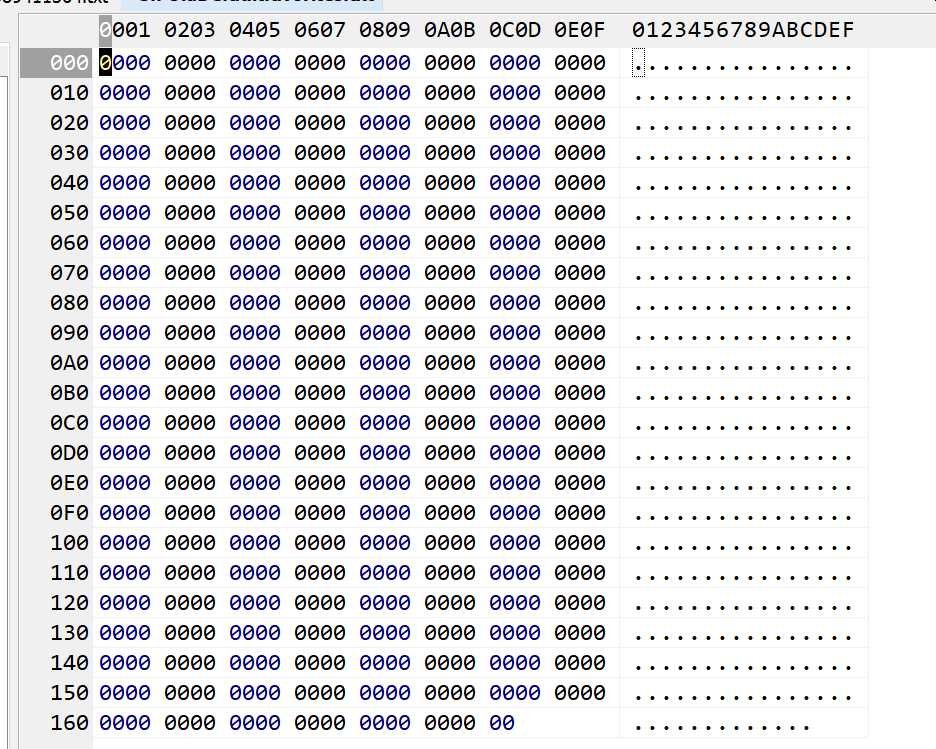

Anyway, I opened the file in MS Notepad, and got no text; I opened it in another text editor and it produced what looks to an ignoramus like a hex display of zeros. I then looked at the file size: 365 bytes. I will attach a picture and hope it arrives.
- sent.jpg (76.07 KiB) Viewed 2434 times
- OldDefaultFavorites.jpg (202.99 KiB) Viewed 2434 times

For the next release, I eliminated the crash caused by a Favorites file that is all zeros (and similarly for Preferences and Theme Files).
