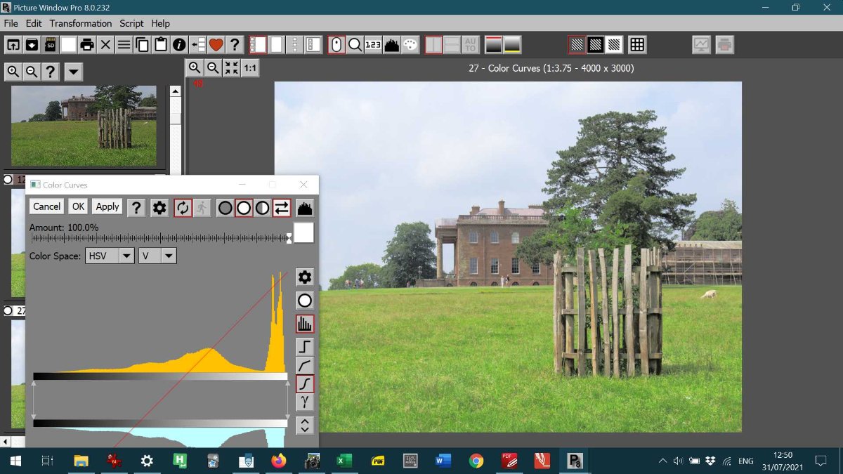

Re: transformation dialogs vanishing
Post by madhg »
Now I see what's going on. It happens when I have clicked on the image or the image background, so that the dialog is not selected and its title bar goes white. See attachment. Then clicking on a part of the title bar which is over an image in the image browser makes the dialog vanish. Clicking anywhere else on the dialog selects it, and its title bar gets its colour back.
The click seems to go "through" the white title bar and click on to the image browser. Anyway, I now know how to avoid it.
Thanks for your prompt input - your suggestion made me to look more carefully into the problem.
