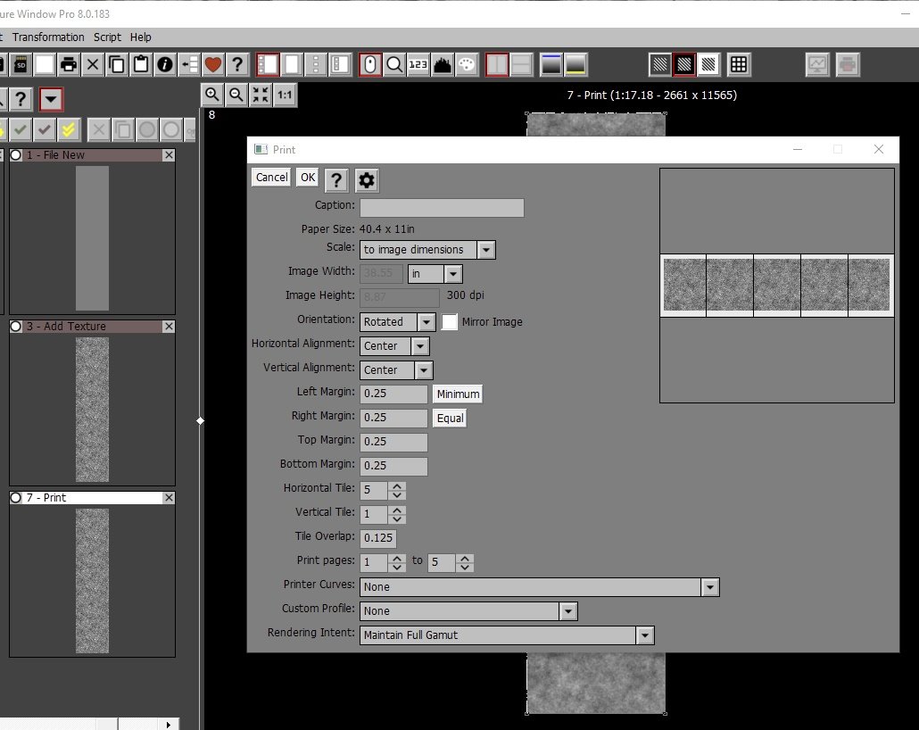

Posts: 4887
Re: Printing a large image
There do seem to be a couple of minor problems with the interface for tiled printing (which I have not used or tested for quite a while). I will fix these for the next release.
1) The print preview part of the dialog box does not automatically update when you change the Horizontal or Vertical Tile setting -- it does update if up change the Orientation setting.
2) Auto rotate does not work correctly with tiled printing selected -- you need to manually select Normal or Rotated.
As in the screen shot, the preview illustrates how the image will be spread across the 5 pages. I created the image 2661 wide by 11565 tall @ 300 dpi -- if you meant it to be horizontal, then just change the Orientation setting to Normal or Tile vertically instead of horizontally.
