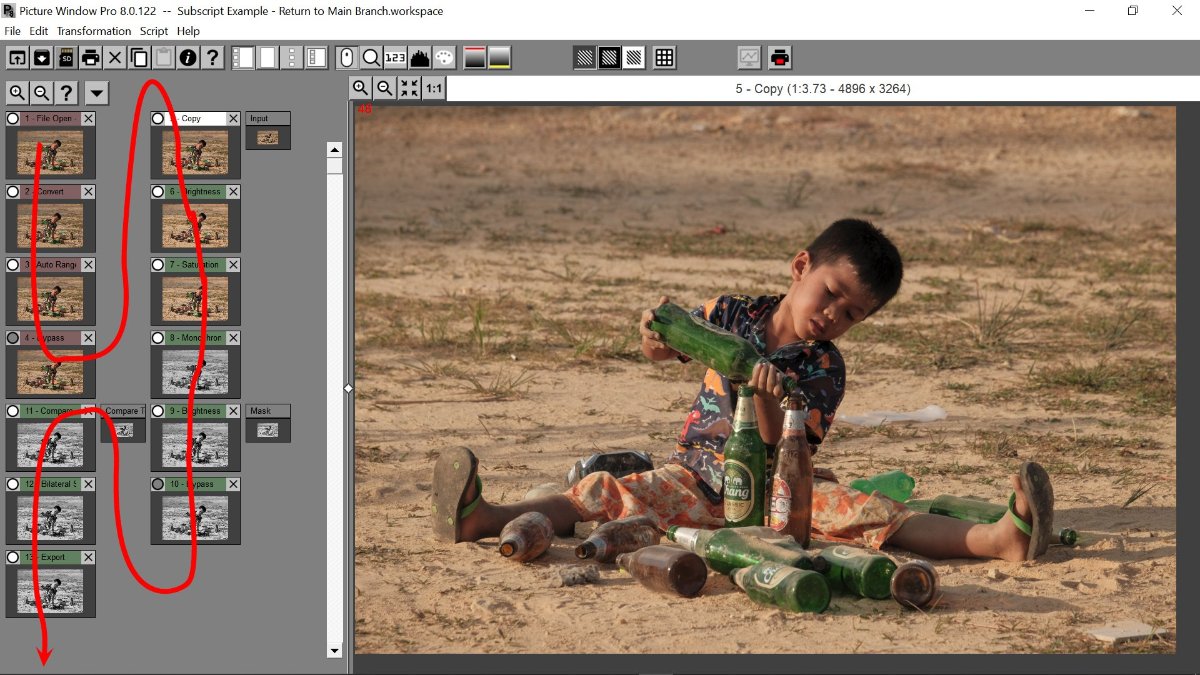

Here is an example of a reusable subscript/subroutine that can be called from the main branch, with a twist that allows the main branch to 'call' the subscript and then continue on (instead of moving to the next top-level branches) - somewhat analogous to the main program calling a subroutine in Fortran or Basic.
Some explanations:
1. The two Bypass transformations are not strictly necessary - they are there in case you would like to insert another transformation either in the main branch or a (sub)script branch without having to change the Input image in Copy transformation or Image B in Compare transformation.
2. The red arrow indicates the sequence in which transformations are executed.
3. The reusable (sub)script is the sequence of transformations that was indicated as a B&W example in the first post of this thread. It can be saved and recalled.
4. The execution starts from 1-File Open of the main branch, proceeds to 4-Bypass transformation and then leaves the main branch by virtue of 5-Copy transformation (the top one in the (sub)branch) whose input image points to the 4-Bypass). It then proceeds downstream of the (sub)script branch until it reaches its last transformation (i.e. 10-Bypass). The execution then returns to the main branch, since 10-Bypass is used as Image B in the 11-Compare transformation. The output of 11-Compare is its Image B. It continues on downstream of 11-Compare transformation in usual fashion until the last transformation (13-Export), which saves the processed image.
5. All of that can be used in a Batch mode if 1-File Open uses a list of input files.

Re: Subscripts?
While this does work (I like the clever touch of using Compare to copy the result into the other branch), it is probably cleaner and less work to just copy the transformations into the other branch and then close the no longer needed subscript branch.
It should be possible to implement a command like this that reads in a script (first checking that it consists of just a single branch), inserts all but the top level image after the current image, and then deletes the script branch. I am working on something else right now but may come back to this later.
