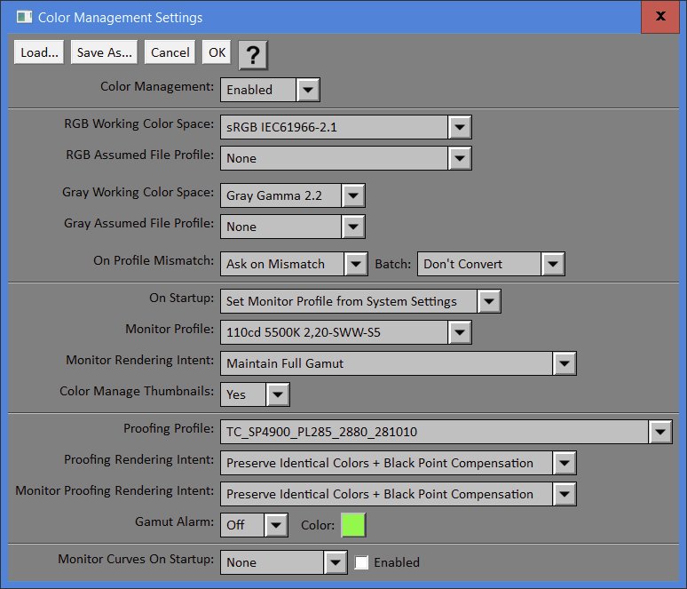

There seemes still to be a problem, at least on my system:
My colormanagement settings: My test with the Farbkreis.jpg, containing the ColorSpin-profil.

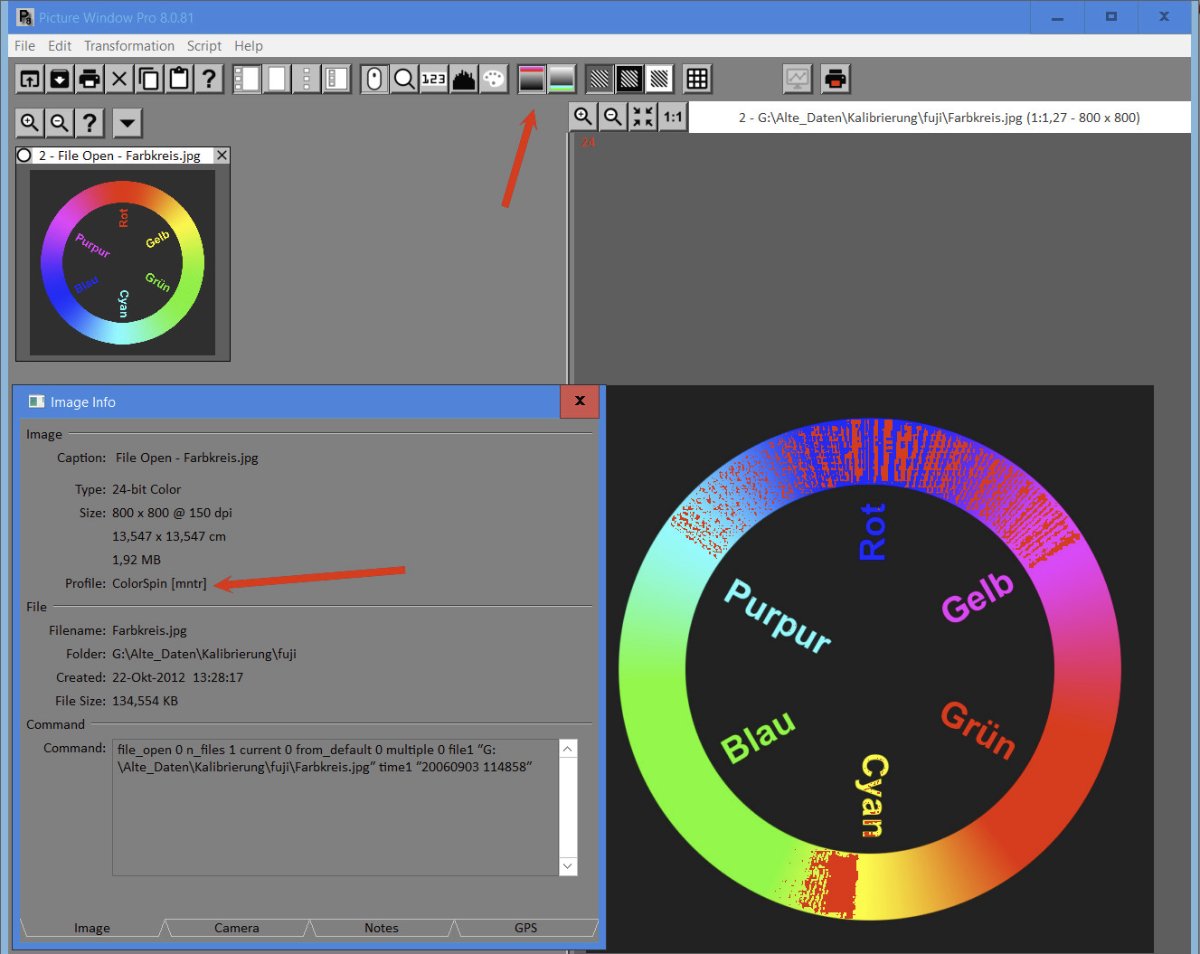

I opened without converting to my working space profile.
The thumnail is colormanaged.

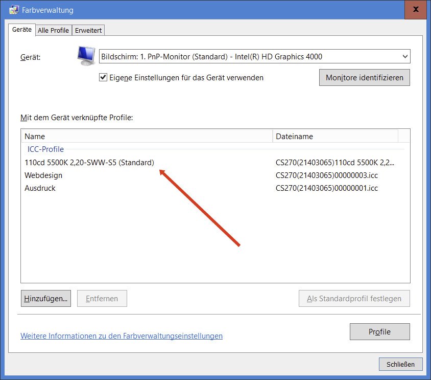

The main image after pressing the highligt buttom not colormanaged. and here the Windows settings:
