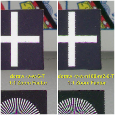

A DPReview X Pro-1 test image RAF file converted with dcraw v9.17 with minimal options: -v [messages]; -w [camera white balance]; -6 -T [output a 16 bit tiff]...
Image area zoomed 1:1: left, base conversion and right, base conversion with added luma/chroma noise reduction...
bDSCF2008_1-1 Zoom Factor.jpg (47.66 KiB) Viewed 106970 times

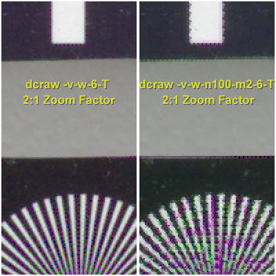

Image area zoomed 2:1: left, base conversion and right, base conversion with added luma/chroma noise reduction...
cDSCF2008_2-1 Zoom Factor.jpg (47.06 KiB) Viewed 106957 times
Note particularly the visual element edges and the apparent difference in camera white balance color casts...

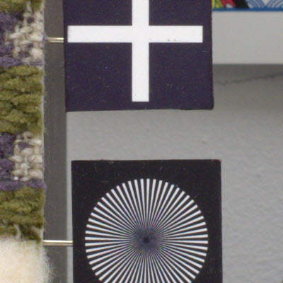

A 400x400 1:1 zoom factor image area of the 1920x1280 embedded JPEG [DSCF2008.RAF (full size = 4952x3288)] previously illustrated...
DSCF2008.thumb-1920x1280_400x400 1-1 image area.jpg (47.91 KiB) Viewed 106759 times
Obviously, camera settings for a full sized JPEG, [perhaps similar to Canon's EOS-350D "RAW+JPEG" setting], are needed and the resolution is limited to 8-bit color depth containing JPEG compression artifacts... ...the in-camera resulting conversion is really not all that bad if the scene is captured with good exposure...

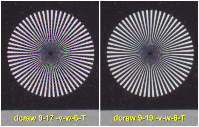

Did not investigate "3-pass". By default dcraw uses "3-pass X-Trans interpolation" for the X-Trans sensors and seems to ignore any other interpolation method option [-q <num>] if specified. Using dcraw's wavelet noise reduction and 3x3 median blur during conversion still produces un-satisfactory results... ...probably best to do chromatic aberration, luma/chroma noise reductions with post-conversion edits of the dcraw RAW converted to tiff file...
Re: Demosaicing Fuji X-Trans Sensor
...Update for a Windows dcraw.exe, version 9.19...
Sebastian Nibisz has made available today a dcraw9.19 windows update for SNS-HDR linked here:
http://www.sns-hdr.com/forum/viewtopic. ... 2974#p2974
This compile will execute in 30 seconds vs. 2 minutes for the previously linked dcraw9.19 files... ...and can be used to update the dcraw.exe file in the SNS-HDR program folder(s) if you have the SNS-HDR program...
The following illustration compares the dcraw conversions of an 1:1 image area of the X-Pro 1 RAF file...

If of interest and you would like to 'pixel peek' the difference between a DCRAW9.17 "Bilinear/VNG interpolation" and a DCRAW9.19 "3-pass X-Trans interpolation" with Mouse On/Off comparisons for a Fuji X-Pro1 dcraw converted camera raw file...
... you are welcomed to visit: http://www.ncplus.net/~birchbay/tutoria ... /index.htm ...
