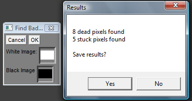

(3) The resulting Badpixel transform screen shot:
screen view 01.jpg (34.9 KiB) Viewed 115559 times
Selecting Yes creates a "8 Dead 5 Stuck.badpixel" file which in text form ["8 Dead 5 Stuck.badpixel.txt"] is and whose coordinate origin 0,0 is the upper left image corner...
