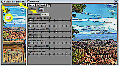

Noticed the following three items regarding Transformation/Special Effects/Watercolor... ...and wonder if these were intended...
(1) a 48-bit color Input image results in a 24-bit color transformed image upon an Apply or OK
(2) rather than a 'default' 2000 Max Dimension, would not the maxium dimension of the Input image be a better choice? with the understanding for visual element "detail" as provided from the F1 Help...

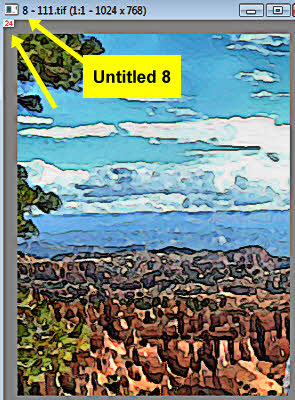

(3) an Apply/OK image version does not have an "Untitled N" format in the frame name prior to saving it to indicate that it is an "unsaved" work space image.

Re: PWP 7.0.7-32 -- Watercolor - ?'s
Posted: April 8th, 2013, 12:19 am
1) The algorithm for fast median filtering applies only to 24-bit images so 48-bit are converted to 24-bit.
2) The stroke detail is related to the image size - this would not work well for very small or large images

Had a chance to look at this again this morning...
(1) the resulting transformed image file size is the same as the 48-bit color Input image when the Max Dimension = the max dimension of the Input image... ...so I would conclude that though a portion of the transform calculations are 24-bit... ...the transformed image is indeed 48-bit and that this is a display issue similiar to item (3).
(2) understand the thinking here... ...just difficult to give up un-necessarily image data!!!
Posted: April 8th, 2013, 10:52 am
The output image is always 24-bit color - this is the way it works - it's not a display issue or a bug.
Posted: April 8th, 2013, 9:22 pm
Yes, I believe this is related to the problem with the title which has been fixed for the next release.
