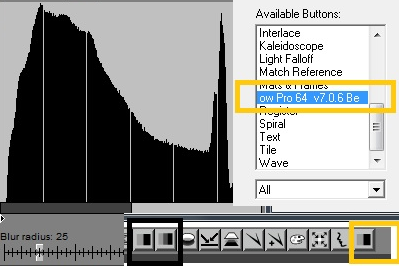

2 Zone dialog box displays white lines in the histogram.
There is a wrong entry in the the Available Buttons list of the Configure Toolbar dialog. When added to the menu, it displays additional 2 Zone icon (not functional).
The two problems may be linked, however the white lines the histogram display whether or not the second 2 Zone icon is added to the menu.
Also the font is now very very small. Why? Was it intended? In the previous version it is OK.
Do not get confused by the attached image. I just tried to stuff both problems into one image limited by 400 x 400 pixels.

Thank you for the report. The toolbar problem will be fixed in the next release.
