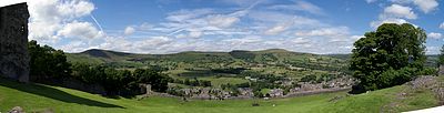

Usually when I make casual attempts at producing a panorama (hand held), I end up with an image which narrows at the ends, for example:
Perveril Castle.jpg (17.47 KiB) Viewed 3826 times
I could just crop it down so as to get rid of the blank areas, but that loses some of the image. What I would like to do is stretch just the ends to fill the voids. The Warp transformation looks to be a likely contender but I can see no way of pinning the warp so as to confine it just to the ends. Does anyone have any solution please?
Ian

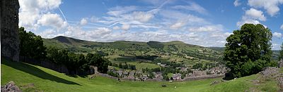

I also tried applying the warp transformation twice in succession, once for the left hand end and once for the right hand end, and that might be the best 'quick fix'. But as you suggest, applying it to the un-cropped file is the best approach.
Peveril Castle warp.jpg (22.25 KiB) Viewed 3786 times

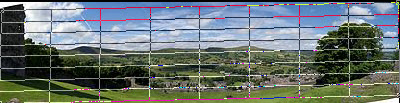

Doing warp twice is a clever idea. You can do it in one pass as follows:
