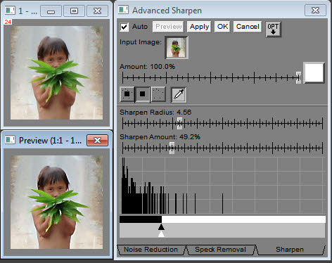

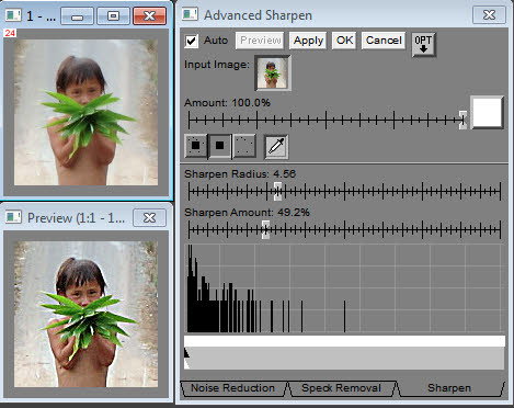

Simulating AS upper roughness threshold - reducing major hal
Posted: March 24th, 2014, 2:28 am
by tomczak
Here is an example of trying to reduce major edge halos in AS. In effect, this technique tries to sharpen only lower (or middle) roughness ranges and protect the major edges from sharpening (and thus prevent or reduce the associated dreadful major halos).
The method is a little laborious and not quite interactive - which makes adjusting sharpening parameters and thresholds a bit of a guesswork, but I think it is quite an improvement over either masking the major edges (which may not get the right, halo-producing edges or mask too much and degrade sharpening effect) or Den's brightness gradient masking (which may affect global sharpening by brightness, regardless of edge roughness). The reason that the roughness - major or minor - has the same AS-definition and allows for smooth transitions between sharpened and unsharpened elements of the picture.
It works by:
1) AS sharpening the image with no threshold (or with some lower threshold to exclude noise from sharpening)
2) AS sharpening only the major edges by moving the lower threshold sliders to the far right of roughness histogram
3) Subtracting 2) from 1), thus leaving only lower roughness over/under shoots
4) Compositing the original, unsharpened image with the 3) in Soft Light mode.
p.s. AS, unlike Bilateral Sharpen, can use soft roughness thresholds (by separating white and black threshold sliders) to further improve the appearance of the sharpened image. Hard thresholds were use in this example. Sharpening and threshold parameters used are probably not ideal, but sufficient to illustrate the technique. Both white and black halos on major edges are reduced - targeting only the white overshoots can further optimize the sharpening, but, if done by hand, further complicates the technique.

The following was shared with me and I pass on to interested Others along with my own added comments...
(1) Maciej's AS1 settings...
(2) Maciej's AS2 settings...
(3) the Offset Difference may be found for PWP7 under Transformation/Special Effects/Difference transform where Input = AS1; Subtract image = AS2; Operation = Offset Difference; and Amount = 100... ...press F1 Help when the transform is 'active' for an explanation...
(4) My preference is not so conservative as Maciej's so I prefer to use a Composite - Hard Light blend with a reduced amount that would normally be applied if Soft Light were used.
