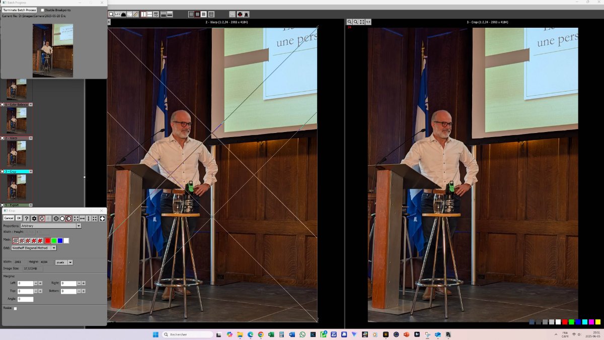

The breakpoint on transformation "2 Warp" is ignored.

I edited your workspace file so the File Open file list had only 1 file instead of 17 and then substituted one of my own test files so I could get it to load. When I ran the batch it stopped on each of the three breakpoints.

It started misbehaving after I abandoned a change on one of the breakpoints. After that the warp breakpoint was skipped on two successive files. I then terminated the batch.
I quit PWP, and restarted the processing by opening the last successful script. Everything worked fine then.

If you were using a keyboard shortcut to cancel, is it possible you held the key down too long and it started to auto-repeat?

I don't remember exactly. I doubt it was auto repeat.
I might have hit a key by inadvertance, then possibly tried to close (x) or pressed escape.
After the glitch, the warp transformation was skipped in each one of the succeeding input files in the list.
