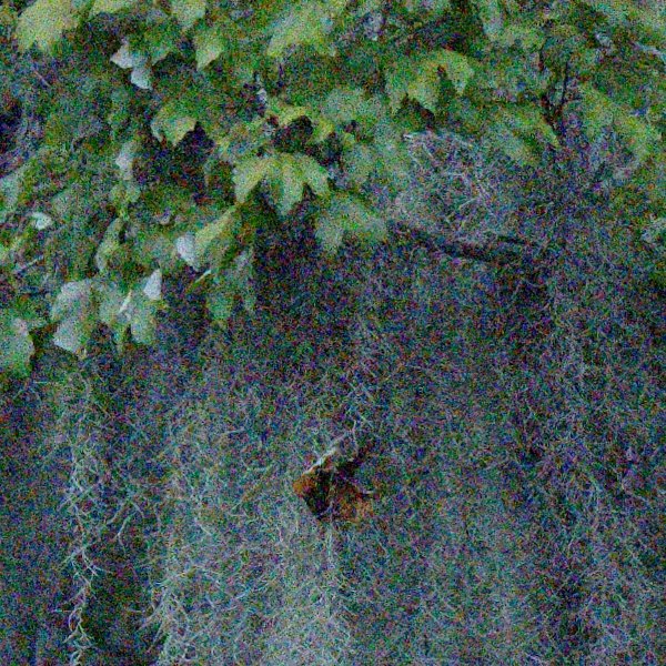

Here is an example of what I was able to get using Photo AI to denoise and sharpen very high ISO image of spanish moss and some leaves (100% crop 600x600 pixels). I was unable to get anything nearly as good out of NeatImage, but maybe I am not familiar enough with it.
Original 100% crop
Original 100% crop

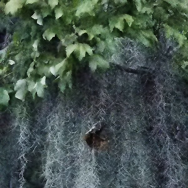

I gave a try, using the tools at my disposal, using Nik Collection's Dfine, Pre-Sharpener, and Color Efex details extractor,
then followed with PWP Advanced Sharpening NR and Sharpening.
Nik7 Dfine-Presharp-ColorEfex-600x600-PWP AS.jpg (144.5 KiB) Viewed 10629 times

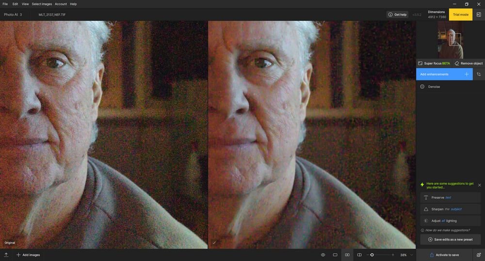

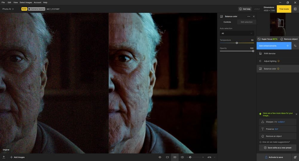

So I tried the trial version of Photo Ai 3.5.2, which does not allow for file saving. But based on the preview, I thought it was interesting that when TIFF files (generated from NEF files in Nikon NX Studio with no NR) were used in Photo Ai, they made the noise, especially chroma noise, worse. When the original NEF file is processed in Photo Ai it does an amazing job of cleaning up the noise and enhancing the image details.
TopazAI_trial_from TIFF.jpg (95.03 KiB) Viewed 10516 times
Not sure why the difference, but it seems Topaz prefers to work from raw data.

PhotoAI has a separate denoising algorithm for RAW files which I assume can work better since it has access to the image before it is demosaiced. This raw denoise method is applied whenever you open raw files.

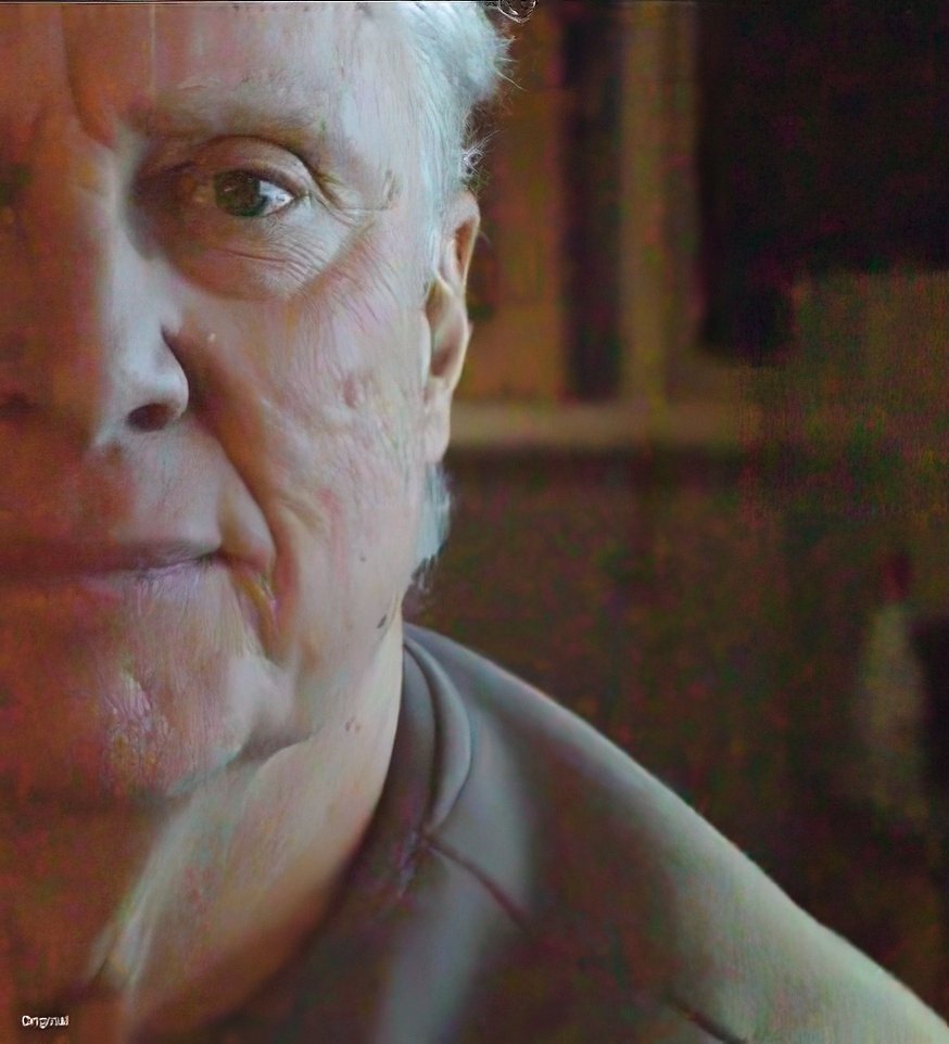

I was still able to improve the image somewhat with the regular denoise algorithm however:
MarkT-topaz-denoise v1.jpg (99.62 KiB) Viewed 10510 times
I think their denoise algorithm doea not work as well near the edges of the image, so the noise on the left hand side might be processed better if more of the image was available.
