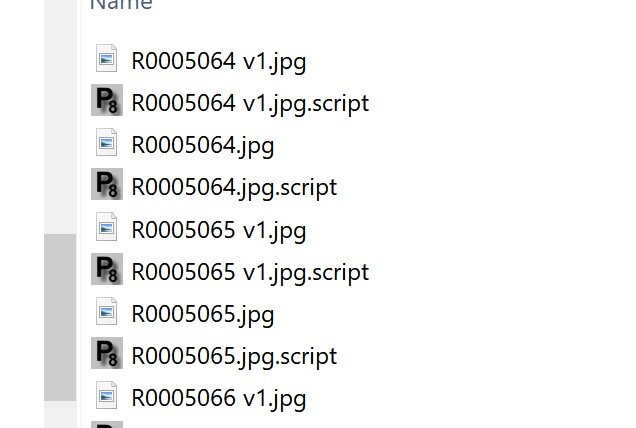

Still struggling to get Scrips alongside my Exports in Batch mode - as posted in that other thread. Can you take a look please.
EDIT. Not sure what I did but they now appear. Bravo..
