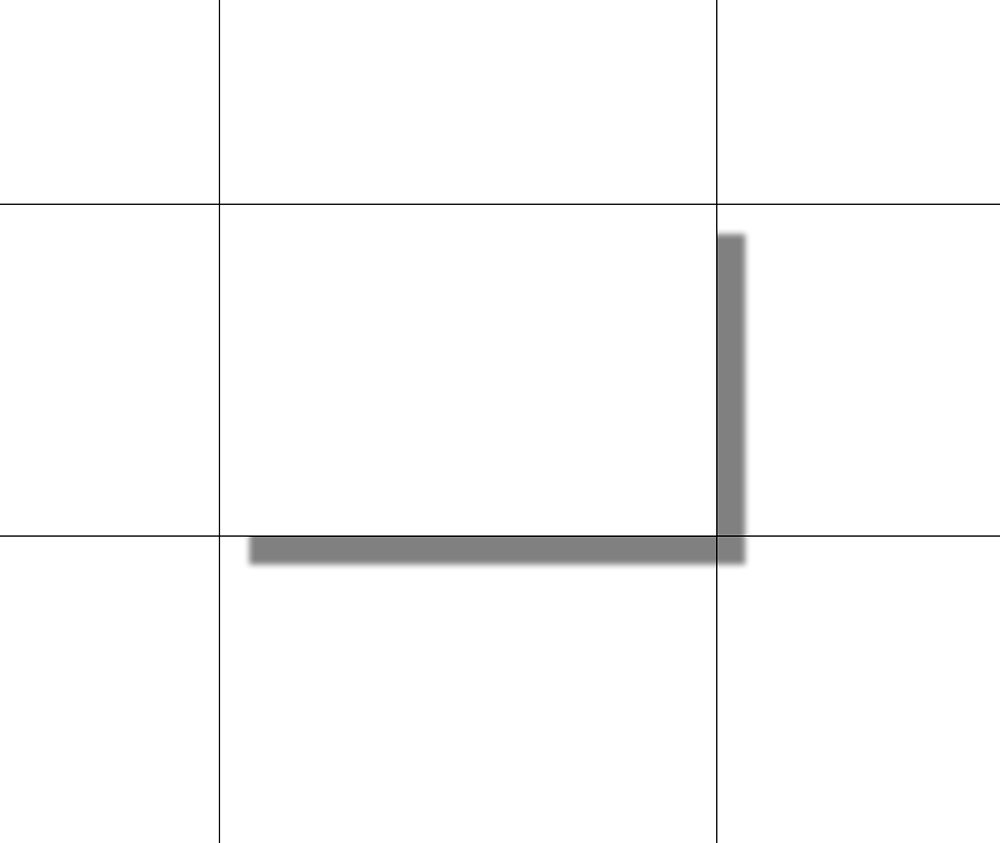

And, I have (hopefully) attached an example of my next question. Is there an "easy" way to have the shadows act like the "object" is grounded and not representing a flat object floating? If the image contained a single shadow, I could putz around and use the clone tool, I suppose, to extend the shadow to the edge, but then I would further have to manipulate things to get the angle (represented by the angle entered in the dialogue box) emanating from the corner/edge of the object to actually look like a grounded object casting a shadow.. Long and tedious.
The example is a simple one where I did a grid on white, then made a mask of one of the grids, then did a drop shadow. As can be seen, the shadow does not extend to the two corners and are not angled away from each of those corners.

Not sure I understand your first question.
As to making regular shadows instead of drop shadows, I can't think of an easy way to do this automatically. The only place in PWP which generates the kind of shadows you are talking about is in the Frame transformation which, for example, casts shadows from the frame onto the wall.
You might try doing a linear blur of the object mask and then subtracting the original object mask from it to make a shadow mask. This produces a mask that extends both towards and away from the light source, so you then need to remove the part that extends in the wrong direction. Finally you can use the mask to darken the original image. Attached is a workspace script that illustrates this -- just change the extension from .txt to .workspace and PWP should be able to open it.
