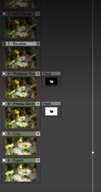

1000021893 (2).jpg (25.42 KiB) Viewed 3821 times
In the case being examined, the Equalize transformation is bypassed. Note that Equalize has no associated mask.
Bypassing the Equalize transformation triggers a complete recalculation downstream.
From thereon, the output of Equalize is not being used downstream, and no downstream mask depends on the output of Equalize ( it is bypassed ).
Moreover, the masks in the Multipass sharpen and Precise Gaussian transformations were created by the Mask paint tool and the mask Blur tool. Both masks are image-independent.
Just before clicking on the close button for the bypassed Equalize transformation, all downstream transformations output images are in their intended final state.
Why would the downstream transformations need to be recalculated?
Re: improvement suggestion : closing a bypassed transformation
Posted: June 30th, 2024, 6:53 am
I was able to reproduce this by adding Precise Gaussian with an initial Amount mask copied from Multipass Sharpen to the workspace you emailed me. Since the initial mask in Precise Gaussian depends on the mask in Multipass Sharpen and Multipass Sharpen depends on Equalize, PWP thinks closing Equalize can affect Precise Gaussian, even though in this case it does not since Equalize is bypassed. Consequently, the close triggers a recalc.
I think I have fixed this but need to do more testing.
