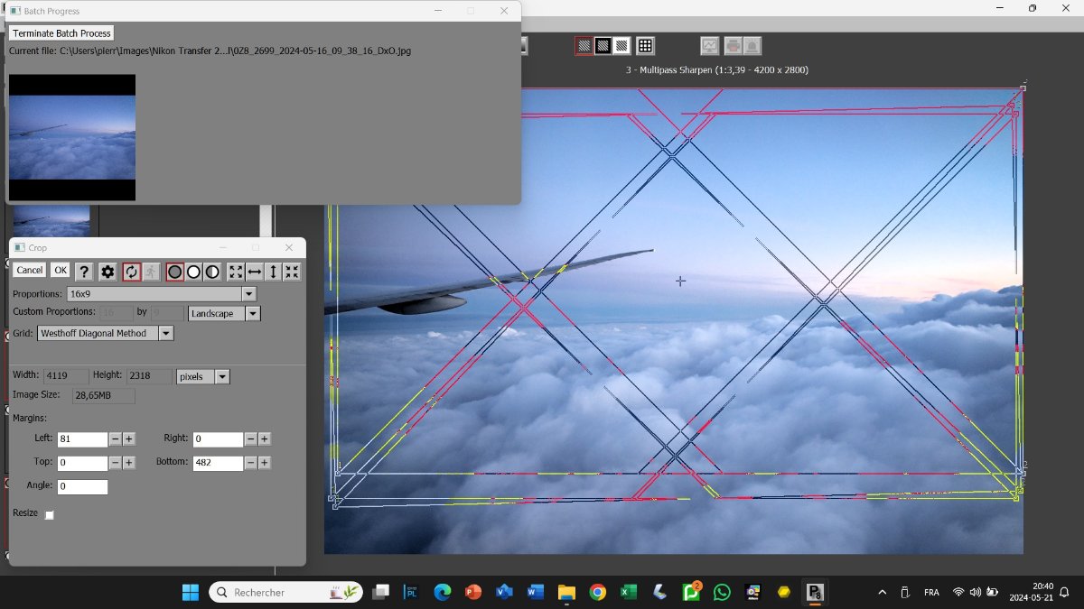

Problem : Reset cropping rotation angle in Batch mode corrupts display
Posts: 744
Problem : Reset cropping rotation angle in Batch mode corrupts display.
Multiple attempts at changing the rotation angle create persistent overlapping cropping outline rectangles
See screen capture below
2024-05-21 problem-  Reset cropping rotation angle in Batch mode corrupts display.jpg
2024-05-21 problem- Reset cropping rotation angle in Batch mode corrupts display.jpg (115.32 KiB) Viewed 1129 times
Posts: 4886
Re: Problem : Reset cropping rotation angle in Batch mode corrupts display
Fixed for next release -- actually this was unrelated to batch but only happened when only the input image was displayed in the main image area.
