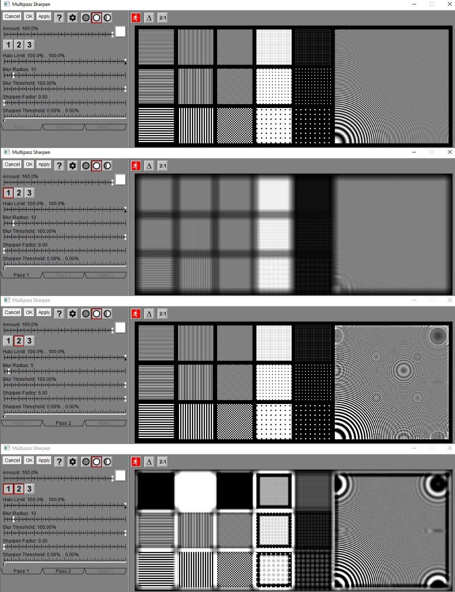

Here are screenshots illustrating the issue more clearly. The behavior is slightly different than what I previously described, so I may have botched the initial report.
For clarity, I’ve used extreme settings and show only Pass 1 and Pass 2.
For both Pass 1 and Pass 2, these settings stay the same: HL (B &W) 100%, BT 100%, ST 0% - 0%.
Unique to Pass 1: BR 10, SF 0.00
Unique to Pass 2: BR 5, SF 5.00
These four screen-shots show, first, all passes disabled resulting in the Display Preview Pane showing the unaltered input image (with some moiré issues due to website scaling).
Second, the First Pass is shown properly.
Third, only the Second Pass processing is shown properly.
Fourth, the correct sequential processing of the First and Second pass is shown.

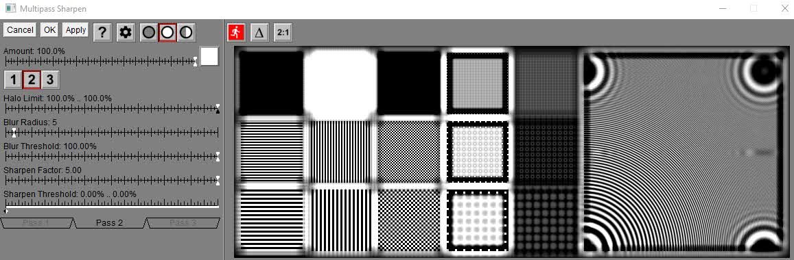

However, in this image below note that the First Pass has been disabled but the Preview Pane is showing the combined processing of the First and Second Pass.
