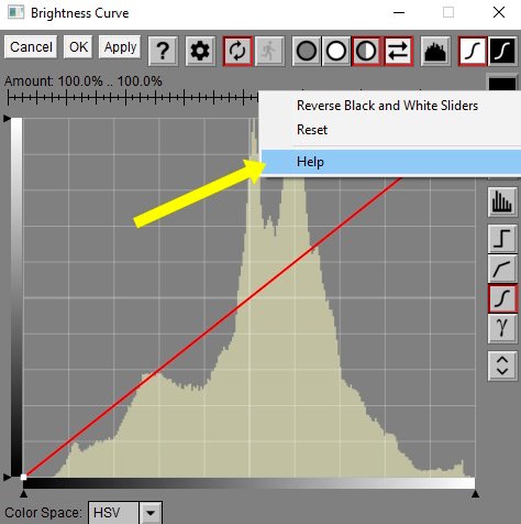

The help text linked here should probably mention this special case as well.
BrightnessXformScreenShot v1.jpg (38.88 KiB) Viewed 2670 times
Might be nice for this transformation to have two separate sliders stacked to emphasize the different behavior from “Double Sliders” elsewhere in the app.
Also, does the “Reverse Black and White Sliders” selection do anything here?

A visual cue such as two sliders instead of a double slider sounds like an interesting idea.
