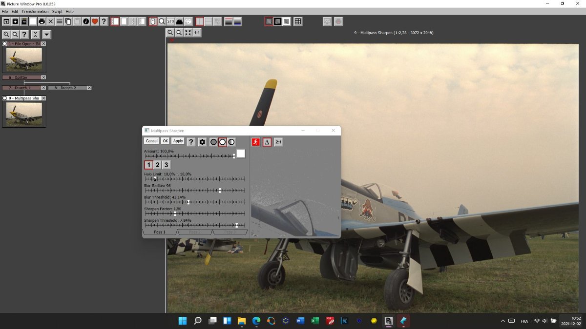

For example, when using Multi-pass sharpening with blur and sharpen thresholds :
Is there a way to avoid the grainy artifacts at the transition between zones defined by thresholds ?
If not, would it be possible to implement feathering in those transformations, with feathering control in the dialog box ?

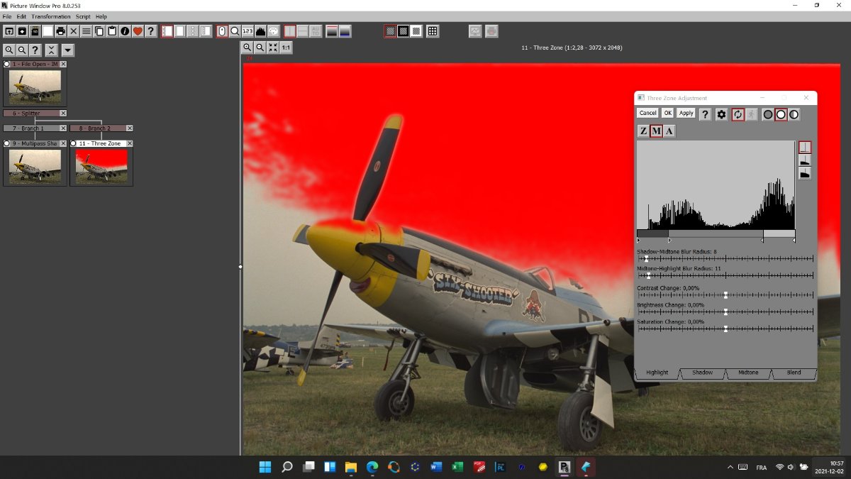

I was thinking of feathering or blurring as found in the Gray Zone transformations.
2021-12-02 Multi-pass sharpen grainy artifacts v1.jpg (105.46 KiB) Viewed 2052 times
Three-zone adjustment
Before blurring, the transitions are grainy.
2021-12-02 Three-zone adjustment with grainy artifacts before blurring.png (302.12 KiB) Viewed 2052 times

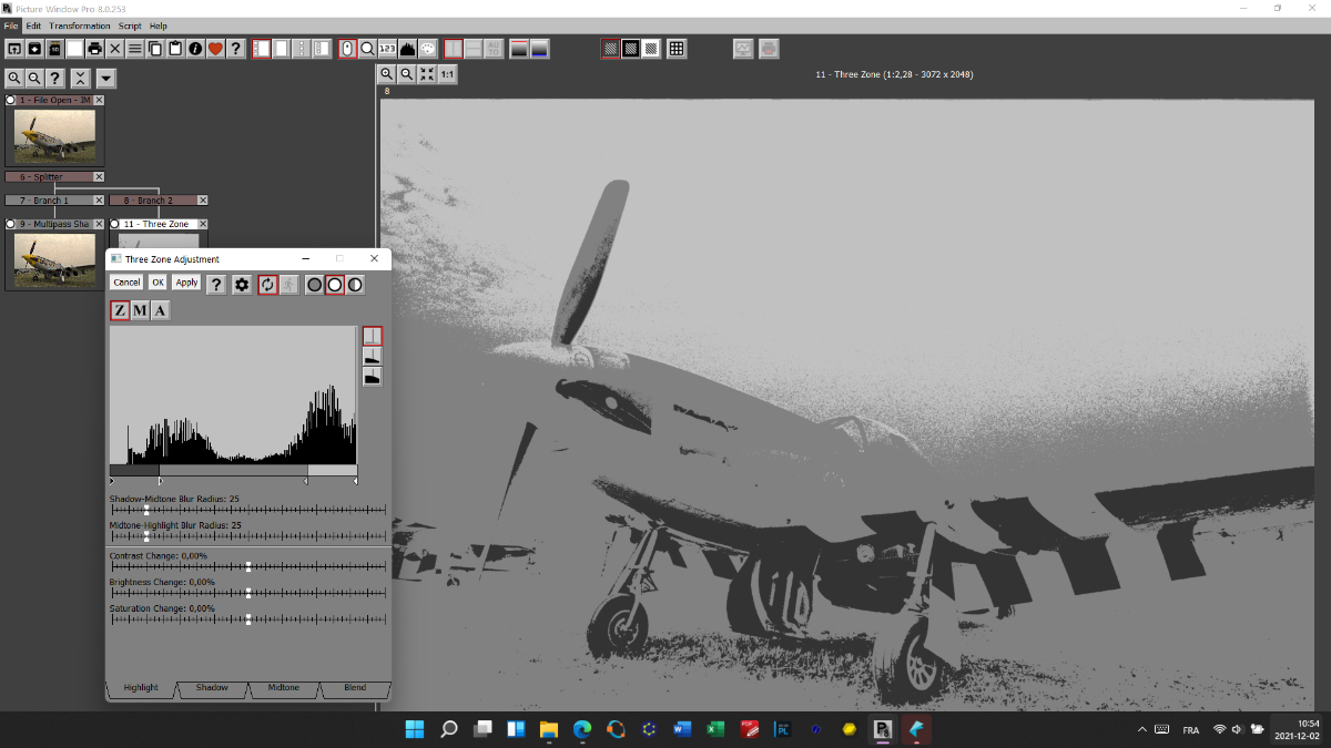

After blurring, the transitions are smooth.
2021-12-02 Three-zone adjustment, after blurring, without grainy artifacts v1.jpg
2021-12-02 Three-zone adjustment, after blurring, without grainy artifacts v1.jpg (108.59 KiB) Viewed 2052 times
