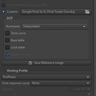

These files are generally dual illuminant. Other lighting conditions are interpolated from them...usually d65 and tungsten for DCP vs D50 for ICC files. Some of the best info on DCP files, manipulating , converting to icc etc comes from an open source program Dcamprof..http://rawtherapee.com/mirror/dcamprof/dcamprof.html and https://torger.se/anders/photography/ca ... iling.html A DNG file can also serve as a dcp file as all the info is generally embedded...I have used dcam to convert adobe camera raw dcp files to ICC as I use Darktable which only supports icc. Rawtherapee supports DCP directly so the code would be available as it is open source....it is nice as you can have access to the color tables and tone curve of the dcp file and enable or disable them..I think Rawtherapee uses Libraw??
